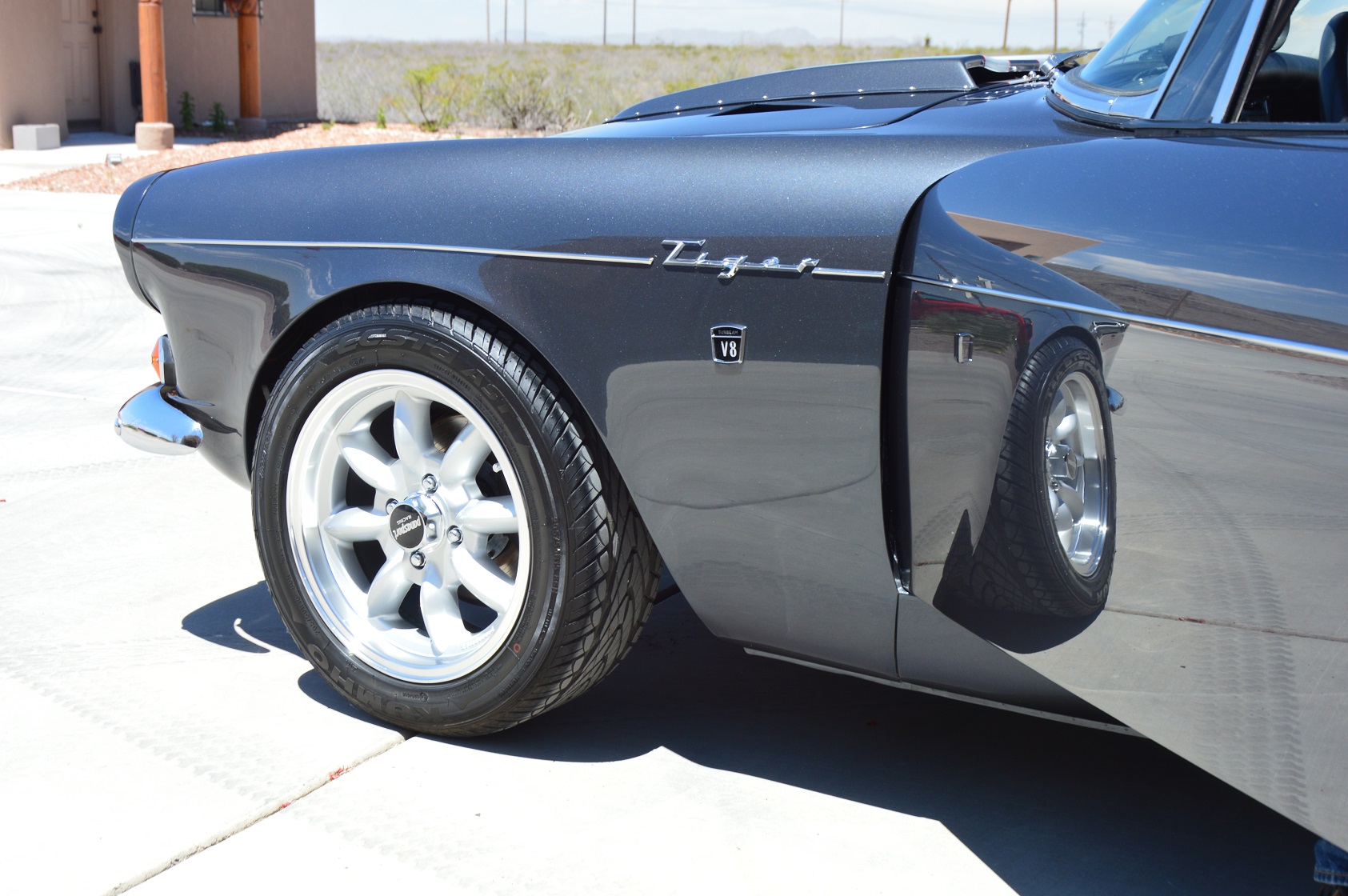

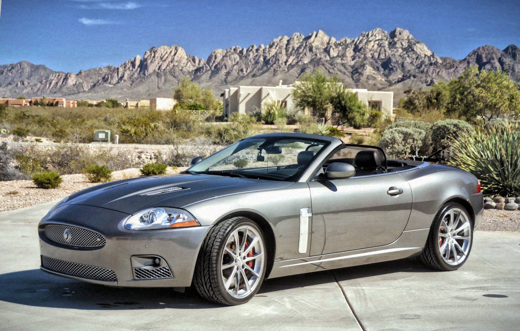

I own a few premium sports cars. 2009 Jaguar XKR, 2014 Porsche 981 and 2015 Corvette C7. 2017 Kia Sportage (non-sport car).
All the cars have a ceramic paint coating.
All of my vehicles go thru this process of detailing as DIY projects, time is the consideration and takes 4 to 5 hours to properly detail the vehicles. This makes a great weekend project and if retired, you should have plenty of time to complete your car.
1) Hand wash with Dawn detergent to remove any oil contaminants.
2) Nano Skin wash mitt (fine grade) to remove micro grit and contaminants from the paint surface that is sight unseen. This is new technology vs using a clay bar which is now old school.
3) Hand wash the car again using a spot free Duragloss car wash.
4) Polish the car using a 6" Dual Action buffer with yellow polishing pads.
5) Polish used is either Meguiars 205 or Blackfire Polish & Seal.
6) Polish is then hand buffed using high-quality microfiber towels.
7) Nano Ceramic Paint Coating used is the Pinnacle Black Diamond Paint Coating V2.
8) Ceramic Paint Coating is applied with a small sponge type Lake Country Applicator.
9) The vehicle needs to sit overnight for the ceramic paint coating to bond to the paint surface. Only 1 coat is suggested. More than 1 coat is not necessary and would be considered overkill.
10) You can apply a wax of your choice but is not needed over a nano ceramic paint coating.
Once this process is completed in these steps, the follow-up to wash and dry the car is a simple 20-30 minute wash and dry. I use an Air Force Master Blaster dryer to dry the car. The dryer provides filtered and heated air. I do not suggest using a lawn yard leaf blower to dry cars. The air is not filtered, and micro debris will hit the paint surface.
The results are superior and can be done as a DIY project for under $150.00 vs a professional detail shop charging in excess of $1200 for the same process.
The shine and reflective qualities of the paint is simply stunning. I belong to the local British Car Club and have done this process for many members who own very expensive classic Brit Cars.
Some photos of my cars and 1 rare Brit Car attached.
