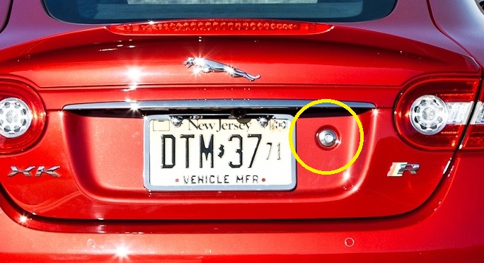

Originally Posted by doctock993
But, car is totally locked with the hatch super-securely closed.
Can't you just use the key (hidden inside the fob) to get the hatch open? In countries with wide number plates the lock is covered it but you should still have one.
Failing that, there is a +ve stud with a rubber cap on in the left rear wheel arch that you can use to power up the car.
