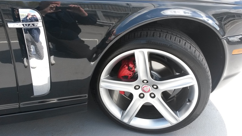

Recently had a Boxster where I painted the calipers and was very happy with the results. MY son liked it so much he asked me to do his Civic Si too. Now that I got my 2007 XK home I just painted them too... all with the same $22 Dupli-color kit (had from Autozone or Amazon) bought a couple years ago. Took maybe 4 hours, degree of difficulty maybe a 1-2. Tools needs 19mm deep well socket, pliers and or flat screwdriver, floor jack, recommend a torque wrench for the lugs, paint kit, a better paint brush @1" wide and a smaller one maybe 1/4", 6-pack of Smithwicks, Simple green or other good cleaner for calipers
Process:
  • Crack all the lugs while car is down. Locate the "jack point" marker underneath then jack the car so one wheel is off the ground slightly.
  • Remove all lugs and remove the wheel (it is HEAVY!)
  • Soak the calipers with cleaner de jour and scrub with brush - no need to leave a perfectly shiny caliper get them as clean as you can
  • Dry with air compressor if you have one
  • Remove the brake pad retaining spring
  • I left the pads in but if you have the time better to remove them
  • Begin painting your first coat, it'll look like crap but don't worry just get paint on there and try not to get runs.
  • Take your time but realize it dries pretty quickly so don't let the can sit open or the brush lay around too long.
  • Now go back and put on a heavy coat
  • Finish with the detail paint brush, it need not be perfect
  • Install the retaining clip
  • Clean your wheel since it's off now reinstall it - my 2007 torque is 93 ft/lbs in a star configuration of course. Now drink a Smithwicks and stare at your work
Total time to do all 4 calipers was @ 4 hours
first coat on rear brake. lighting makes it look orange but it is bright red
second coat minutes after first
