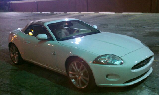

i live in detroit, mi and it was 19 degrees yesterday.. but no snow on the ground. i got my jag wash and parked it at my business... when i closed for the day i came out and tried to open the car door. it was frooze. finally i got it open... with a little forceful pulling.. got in it and shut the door... and it didnt close... the lock is frozen.... go figure...so i had to drive home with the door open... pulling it with my right hand the to keep it from flying open on the freeway. the gear selector warning on the display... with the ding ding ding ding ding sound ringing constantly ... had i known this was going to happen i would have never pulled her out the garage ...these cars are very sensitive...guess i'll take her back to the jag dealership to get the lock fixed.
Attached Thumbnails Do you drive your XK/XKR in the winter (northern climates)?-img_0329-2-.jpg

Three suggestions - from past experience - before taking your cat to the dealer. 1. Park it inside a heated garage for several hours. 2. take a portable hairdryer on high to any locks or flaps (fuel tank filler) that might be frozen. That will defrost and get rid of the ice. And 3, don't get your car washed and then expose it to 19f degree temperature before it has a chance to thoroughly dry out.

Same thing happen to me, I sprayed the locks and eventually she got use to cold weather and has not happened since. Never happpened on VDP

hello,
Thank you for all the post to resolve my issue with the frozen door.
so i finally had time to day after work to try to do the hair dryer and oil the door lock...before i take it to the dealership to get sandbagged and bent over ... i parked the car in my garage a couple days ago when she started acting up.... the garage is not heated but the temp in Detroit today got to 48 degrees. i left the key fab in the house intentionally so the door would stay locked. i walked out to my jag like it was going down.. i armed myself with the 3 in-one-oil in one hand and a hair dryer in the other ... i pulled on the drivers side door... and it stayed locked and wouldn't open... so i went got the key fab and opened the door... to my surprise ...the car fixed itself.. talk about relieved... i could see the bill at jaguar of Novi.. $1600 for new door lock assembly... lol... i did squirt some 3-in-one on the lock mechanism... so this doesn't happen again..
lesson learn... don't get ur jag xk washed on a below 20 degree day and think somethings not gonna freeze..
attached is a photo i took on one of the days i got her washed and drove it in the snow to my biz... the picture is not the day she got cold feet and froze up on me.lol..there was no snow on the ground that day
