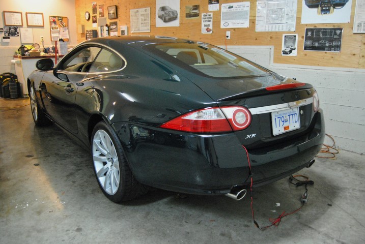

Or, you can charge the battery and then fit a battery maintainer such as the CTEK. The fact that Jaguar sells this under its own label (as does Audi, Mercedes, BMW...) should suggest something. See the photo of my happy and absolutely trouble-free XK with the CTEK unit plugged in.
