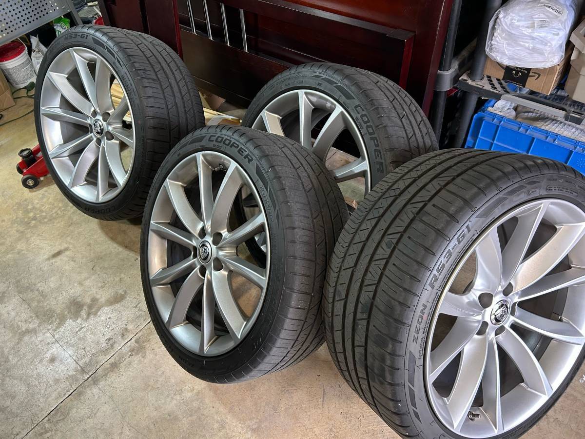

I am a few hours away from them, so have not actually seen the wheels up close. I have asked the owner/seller to provide the offset.
here is a pic of the four wheels.

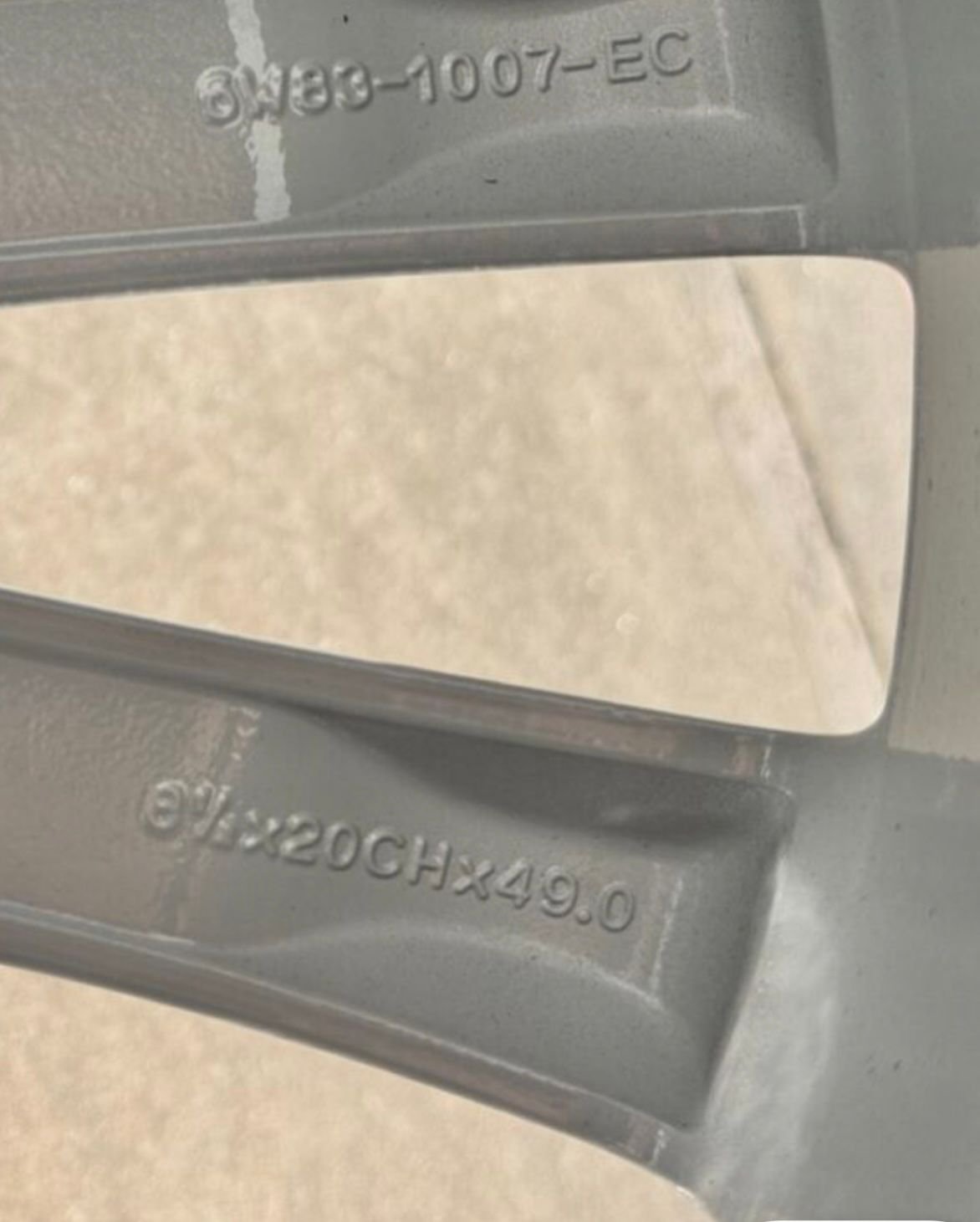

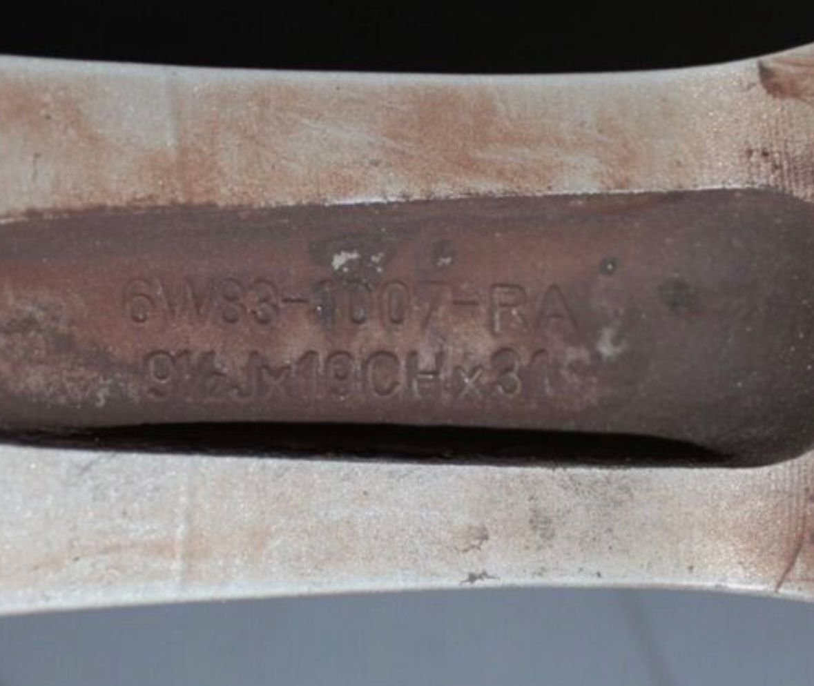

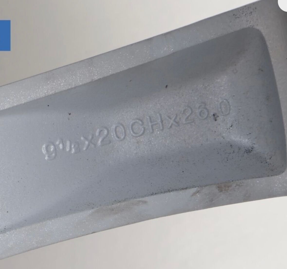

The 20” Senta wheels for the 2007-2009 XK/XKR have front offset of 49, and a rear offset of 26.
The 19” Carellia rears have a 31 offset.
Senta front wheel
Senta front wheel
Senta rear wheel
Senta rear wheel
Carellia rear wheel
Carellia rear wheel
