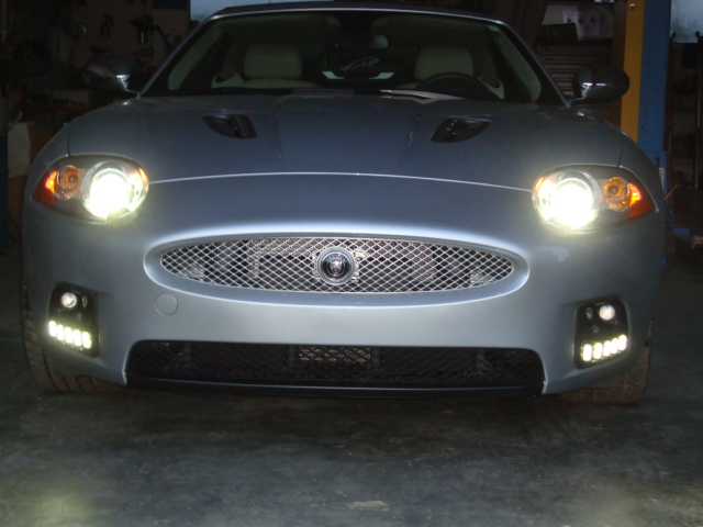

I dont think the XK has the fog light covers same as the XKR ?. see Pics.
If not you could use your fog lights as you suggested as DRLs By having the Fog lights tuned on all the time as they only work with the ignition on . And if you connect a relay to the power at the fog light itself and connect the wire from the relay to the park light , then when you turn on the headlights it will turn off the fog DRLs . I would get hold of Steave at jag wrangler, he will be able to explain it better than I. Bernie

Default Finished
With thanks to "sherbercars" and "WhiteXKR" for their advice, I now have working LED DRLs on my '07 XK. They also still work as Fog Lights, should I ever need them.
Pictures attached, of my Jag and the second with her new eyes and her big sister.
And yes, "powerhouse" these are the lights from Adamesh
