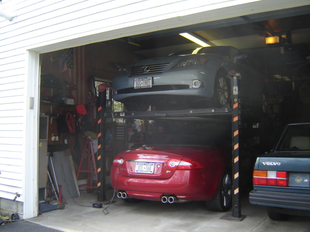

Same here with mine. Just checked it today as when I pull into the garage I need to be in between 2 of the 4 post lift. When both front sensors trigger at the same time I know I'm centered.

I have a 4 post lift, I have not had a reason to lift the car as yet, Q. where are the jacking points, does not show in the owners manual . Thanks Bernie
On my 2012 you can feel under the lower rocker panel near the back and near the front and you can feel a triangle recessed in the panel. you should also be able to see then if you look under the panel. Here is mine centered under the lift

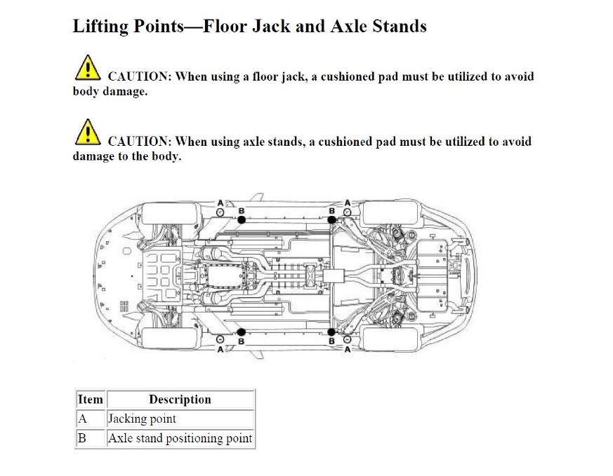

Bernie,
It's only in the Workshop Manual:
Presumably Jaguar don't expect owners to attempt anything so technical!
