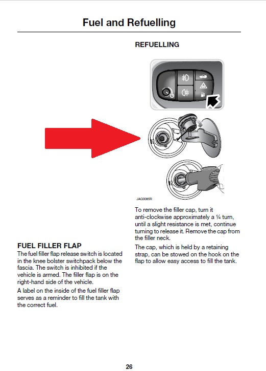

A secret revealed only to those who read as far as Page 26 in the Driver's Handbook.
Attachment 128387
Yup, RTFM, as they say. Every now and then I pick it up, there is stuff in their!
