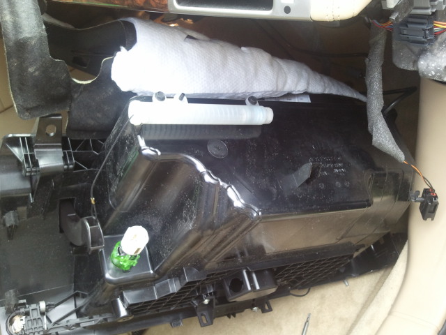

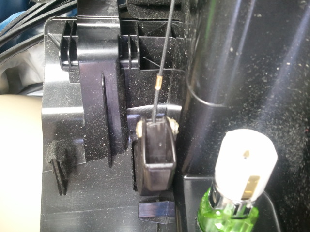

Glove box is now fixed and it's great to have it open slowly! It took about an hour to complete since we did a bit extra by making an aluminum sleeve that went over the screw to avoid any wearing and breaking of the loop.
Thanks 07XKJaguar for the details!
I've attached some pics of the job.
Notice white tube where the spring is housed. The loop is hanging below and to the left of the glove box.
Loop hanging
The pieces for the fix. A bolt, nut, and 7mm aluminum sleeve
The fix. It was easier to remove the plastic tube housing the spring to release the tension.
Loop hanging
