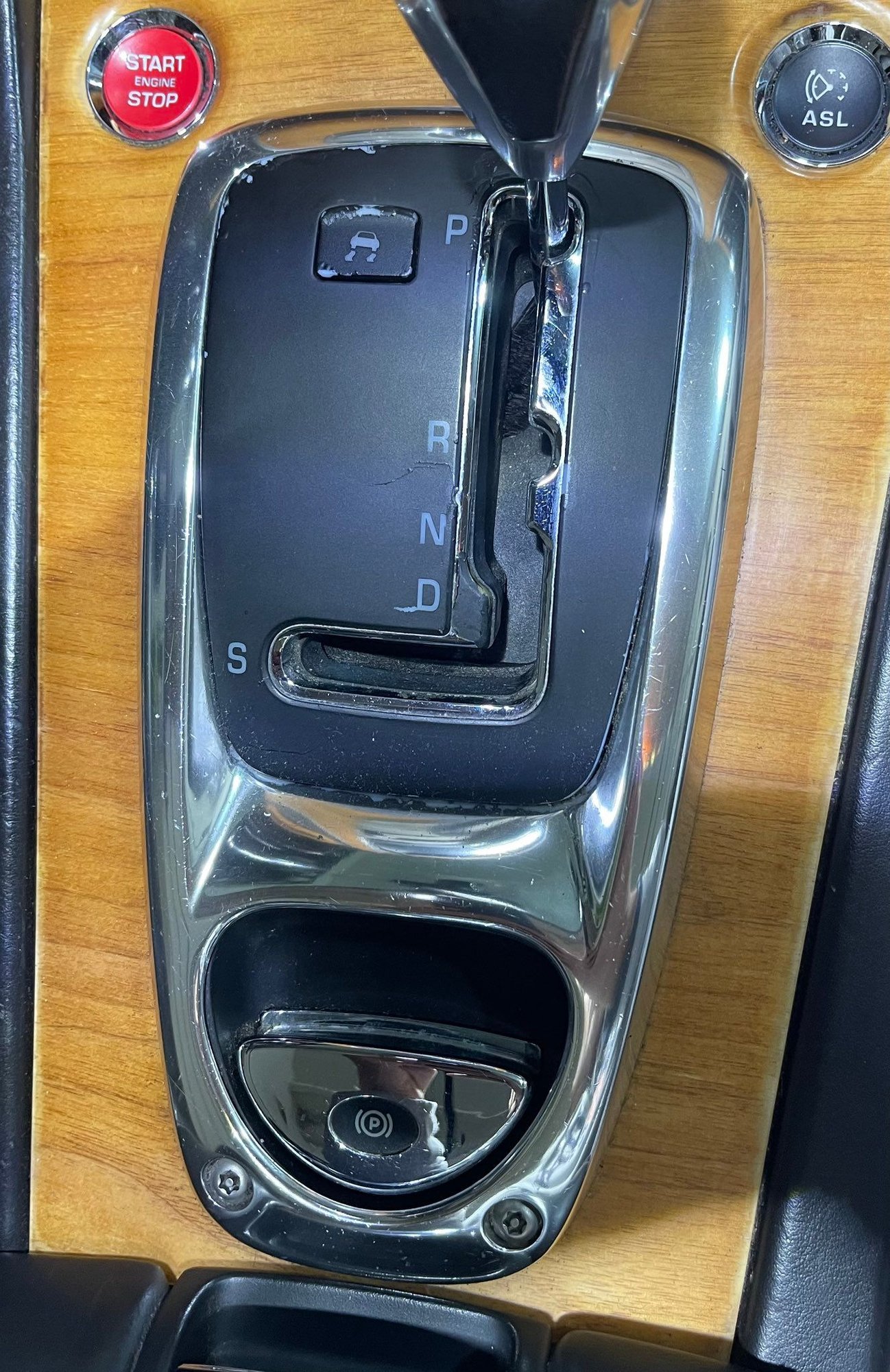

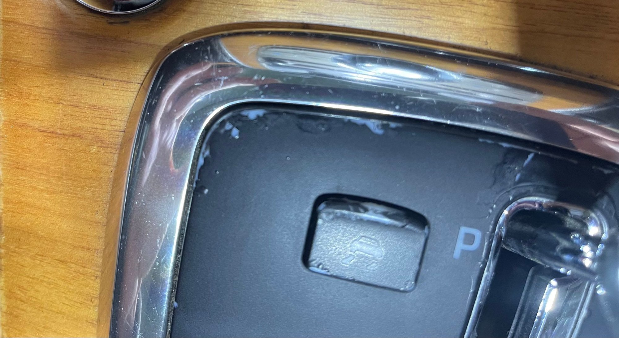

Now that I've finished the Mr12V project, I'm bringing this one back to life.
All the above links are dead.
My 2008 XKR Portfolio J-Shifter has some bumps and bruises I'd love to clean up.
Read the main 6 threads on this and decided this one had the most useful info.

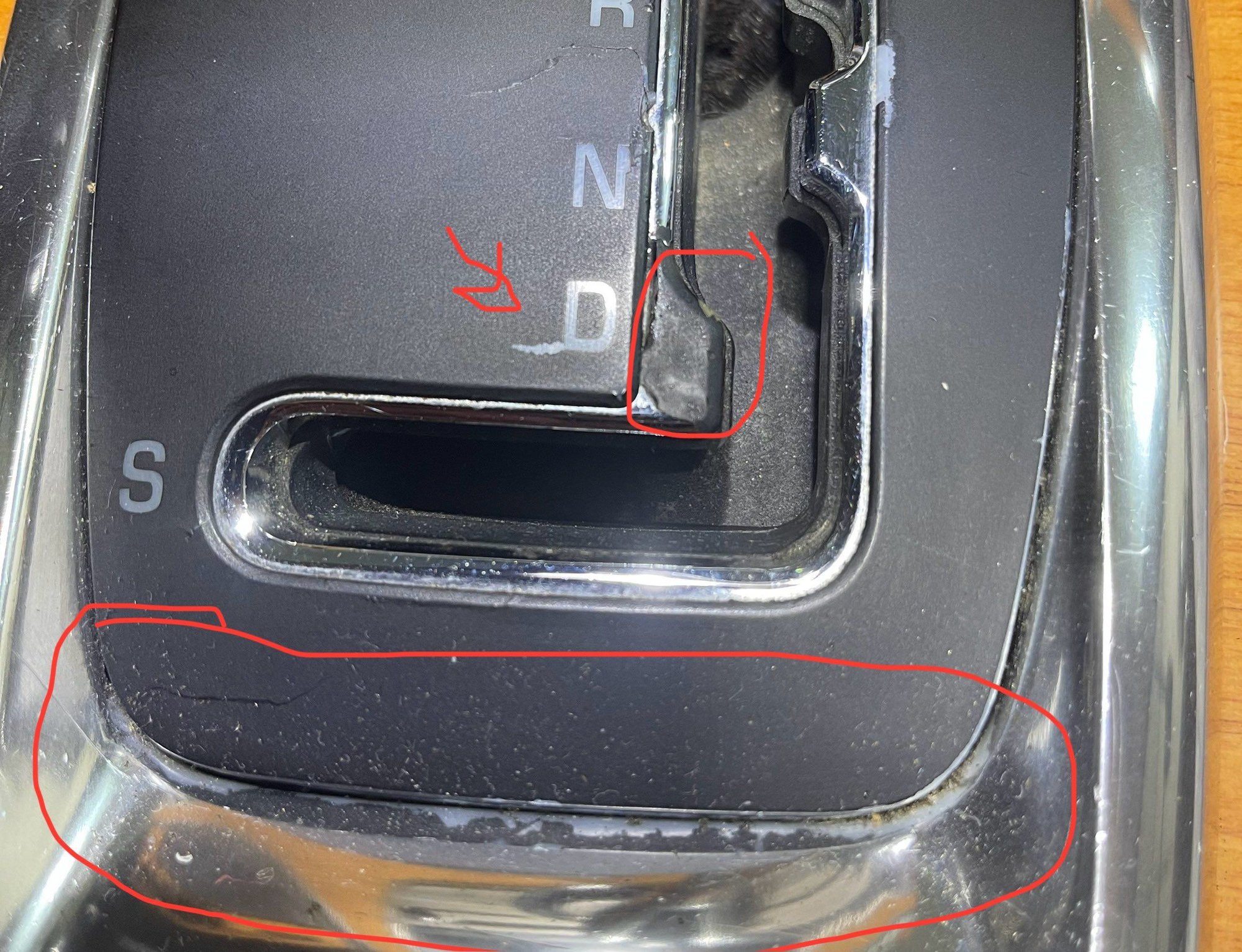

I have two issues.
The inside of the J-Shifter gate, as you will see below, has a chunk broken off next to the D. Obvious plastic underneath.
Then, all over the black, including the traction button, bits and pieces flaking off. Way worse than any of the pics folks posted above.
Now, the overlay solution sounds and really does look great, but keeping this rare gem original (or the parts to restore to original) is my primary goal.
So placing a giant sticker on top I'd think would do more damage removing down the road.
I'd say I am stuck waiting forever checking ebay for an entire assembly that is near mint and swapping it.
And none of the ones currently on ebay are much better than mine, certainly none perfect.
Has anyone come up with better solutions since the above thread?
Like a flat paint that can be applied while covering the gear indicators so they don't get painted?
