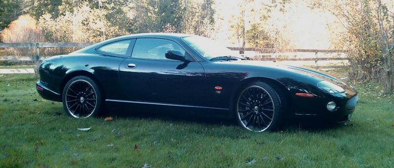

Default Refinished stock wheels
This is what I did with my wheels. Still stock, but customised.
Old Nov 23, 2012 | 01:03 PM
mosesbotbol's Avatar
Joined: May 2008
Posts: 6,286
Likes: 1,208
From: Boston, USA
Looks great!
Old Nov 26, 2012 | 08:56 PM
DenverDDS's Avatar
Joined: Nov 2012
Posts: 66
Likes: 69
Please tell us more! Look great! Did you powdercoat or paint? How much?
Old Nov 27, 2012 | 04:49 PM
djgold's Avatar
Posts: 166
Likes: 34
From: Canada
Love them. Nothing better then huge wheels with small sidewall tires. It really dresses up the car, removing those ugly factory wheels is the first thing that must be done... Why would you want a car with factory wheels that look like every other XK(R) out there? Put some personality in your ride...
Old Nov 27, 2012 | 08:00 PM
growler05's Avatar
Posts: 188
Likes: 33
From: Sunshine Coast BC Canada
I used a product call Endura. Its a 2 part linear polyurethane as far as i know. It is used on planes boats and cement trucks. Very hard surface.
I dismantled each wheel being careful not to shear any of the bolts off as the car is from Ontario and the salt had made the bolts a little tight to get off.
I carefully tapped the spokes out from behind with a rubber mallet and marked each of the wheel parts so they went back into the respective rims when it came to reassembly.
I washed the spokes well with a degreaser and pressure washed them so they were really clean. I sanded the surfaces by hand with a fine paper to key them well for the primer.
Then my friend who does custom painting sprayed them for me. First a coat of primer and then flat black and lastly satin clear coat. This gave them the depth and the anthracite glow.
It cost me $250.00. That included the paint. Money well spent I say.
The chrome outer rings on the wheels were were not possible to remove without damaging them more than they were from the curbing they had received before I bought the car.
I purchased a plastic abrasive wheel, kinda like a wire brush but made of stiff plastic. I put the brush in a fast drill and brushed the chrome until it had a satin chrome finish. This detracted from the curbing scrapes and gave the finish that went well with the satin black spokes. I have very little chrome on my car so that was OK with me.
I then reassembled them being careful to get the right centers with the right rims, mainly in the event that they were balanced as a pair and used a compound on the bolts to prevent them corroding and torqued them evenly.
The whole process took me less than 4 hours.
Could not wait to get them on the car. So here they are.

Thanks for the info! I think they look great and much less expense than I thought! A fair amount of labor but no too bad. I have 20" Sensa wheels on my XR but they look a little different than your wheels...more small bolts I think. I wonder if they come apart like your wheels did?? It would be a good winter project for me when the snow flies.

I have read others that say the wheels should never be taken apart and/or they are impossible to get the bolts out?? Mine look like a special socket is required. They kind of look like torx heads but have many more grooves. Since you did yours have you had any issues with balance or roundness? Thanks! I would love to do mine this winter while she's sitting out the snow!
