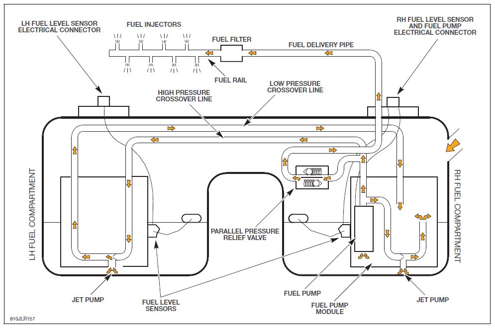

I just finished parking the car on the lift today and had another chance to look under it. I see Jag continues with their twin gas tanks but I couldn't see the crossover pipe. I followed the inlet pipe up to the gas cap. Up near the top of the filler neck just behind the gas cap there is a small can located down about 6"-8" below the fill cap. This looks like a small liquid/vapor separator. So the net for me is I can fill the tank about 8" below the cap. Next to the vapor can just above it is the tubing that goes into it and then there is a piece of overflow tubing that runs along the lower fender panel. Just a little info in case anyone wanted to know.
If you mean two separate tanks, it is actually a saddle tank but would look like two from under the car.

As i looked at the tank and based on the earlier post I see it is a saddle tank I have a new question. The inlet from the fuel fill is about 3-4" up from the bottom of the right side tank. I also don't see a cross over pipe and the fuel pump is in the left side saddle tank. I wonder what the inside looks like because I can't see how the fuel gets from one side of the tanks to the other. Just curious not ****.

All the plumbing is internal. These pictures should help.
To answer the original question, I always fill my tank until the pump cuts off then carry on to the next complete litre. Not sure why really, maybe it is my OCD, but I have never had an issue doing that (other than wet shoes once!).

Excellent , so I see there are 2 jet pumps and 2 floats . Interesting method to transfer fuel to each tank. Live and learn and I bet this is expensive. Thanks.

I guess it means no fuel starvation under heavy cornering. And having two floats means more accurate fuel level reading (the auxiliary junction box averages the two readings).
