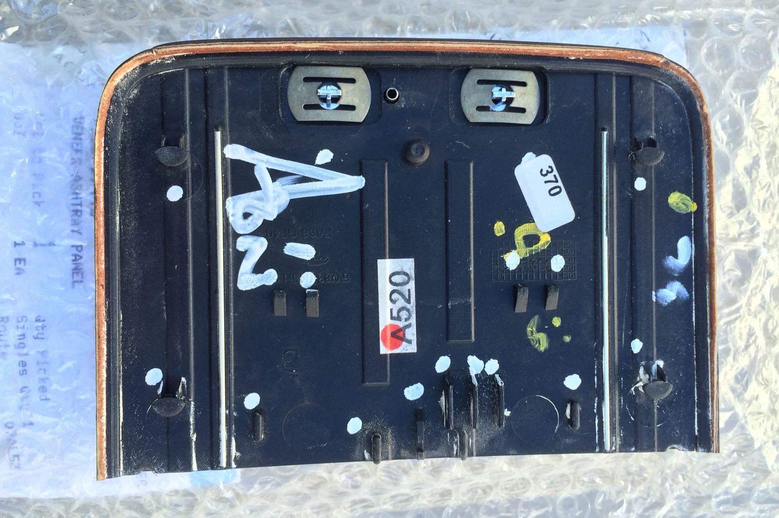

There are 4 tabs. Here is a pic of mine flipped over, maybe that will help.
Attached Thumbnails How to remove center console wood trim pieces?-%24_57.jpg

That's very nice of you! Thanks! I can see the tabs but that sucker is not sliding off! I'll regroup and try again when I'm not so frustrated!

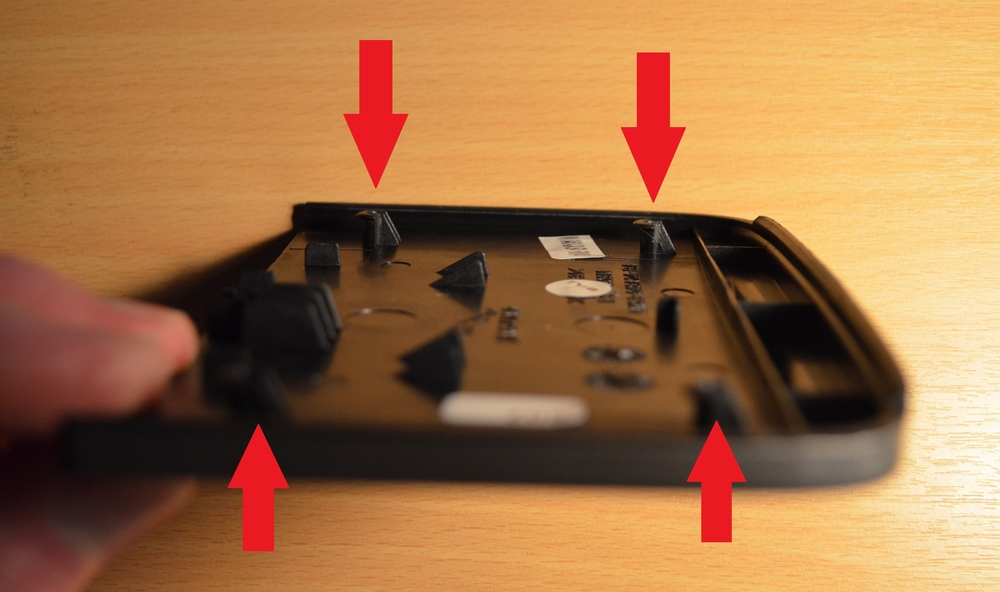

I suppose that's quite possible if one of more of the four plastic locating pegs on the underside of the ashtray lid have been broken.
Attached Thumbnails How to remove center console wood trim pieces?-veneer_2.jpg
