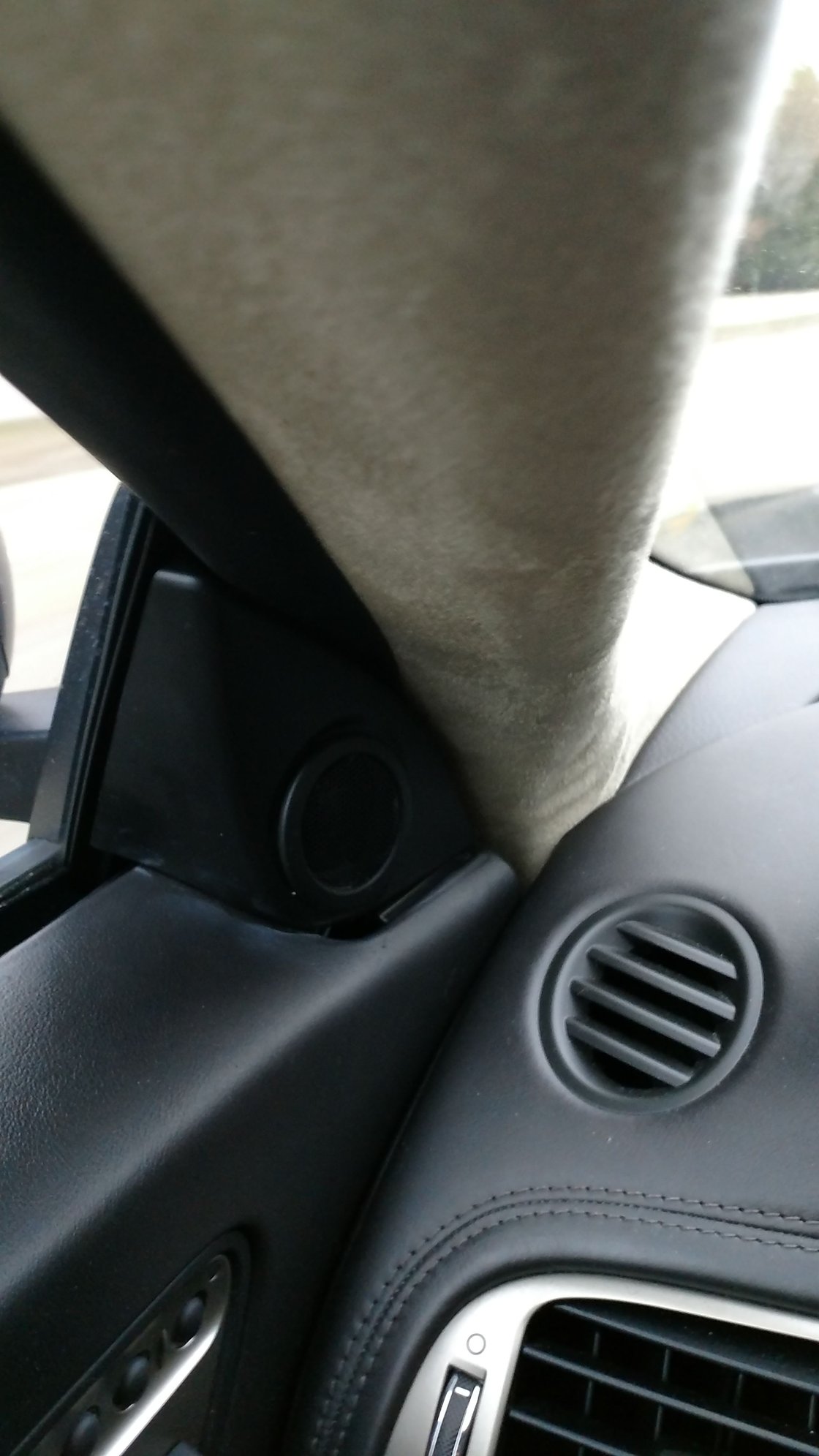

Hey Cats,
I continue remediation on my 2008 XKR convertible. Very clean car when I got it and a few items needed attention. One is what looks to be a fitment issue with the drivers side door inner panel. In the image you can see a gap just under the tweeter. I am assuming that a clip is not correctly seated or missing. Before I take off this inner door panel to inspect, I'd like to get an idea of any issues or gotchas in attempting this. I do most if not all work on my cars, but this will be the first Jag interior I will be working on. Any recommendations, thoughts or experience is greatly appreciated. Also, looking at the a-pillar suede covering which appears loose. I'd like to get some feedback on correcting this also.

if I remember correctly there's a couple (2 or 3) torx screws in the bottom of the arm rest holding the panel on, that and a bunch of snap fasteners that you lightly pry open preferably with a flat blade screwdriver maybe cover it with teflon tape so it doesn't scratch or use plastic tools as I did. Looks like someone had the door panel off and fitted it back terribly but not a big deal to redo. VERY easy job, if you were near San Diego I'd say bring it over and we can remedy that in a couple minutes

I have that gap, but on the passenger side. In fact, the whole panel has a gap along the edge of the window, which is wider than the close fitting panel on the driver side.
I'd read that there was a problem with these panels warping, causing it to pull away at the top edge. I'd like to fix it, but its sort of way down my todo list.

Problem is with the door retaining clips if you give the panel a tap at that corner where it meets the tweeter it should pop back in and close the gap if it does than you have to take the panel off not to hard and reposition all the clips at the top of the panel and then reinstall

Definitely an issue with the way it is fitted to the door, it should be nice and snug all the way around. You will have to carefully remove the inner mirror cover (tweeter housing) to reveal a screw, also screws under the grab handle and one under a small cover at the end of the door in the jamb. The rest is held in with clips. I suspect the issue lies with the metal clips along the top edge where the panel attaches along the glass, if they are bent or not fitted correctly you will see the gap you describe.
