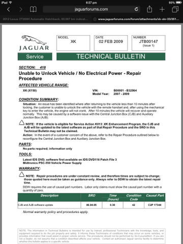

It sounds like you may be another victim of JTB00147:
VIN: B00001 - B32964
Model Year: 2007 - 2009
CONDITION SUMMARY:
Situation: An issue has been identified where after returning to the vehicle less than 10 minutes after locking, the customer is unable to unlock the vehicle with the remote handset and, after using the mechanical key to enter the vehicle, the engine will not crank. After 10 minutes the vehicle will recover and operate normally. This may be caused by a software issue with the Central Junction Box (CJB) and Auxiliary Junction Box (AJB).
The solution is to update the CJB and AJB firmware.

Looks like you've potentially diagnosed the problem amazing work from across the Tasman !
CONDITION SUMMARY:
