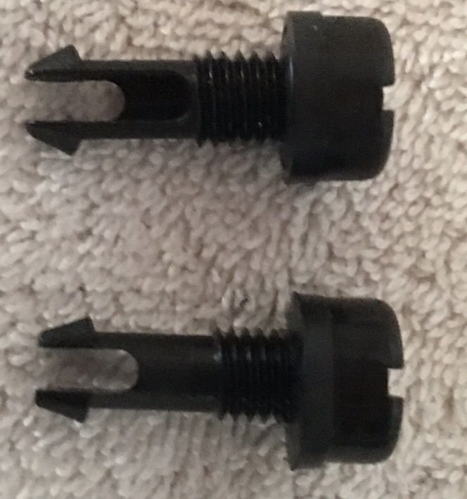

Here is a comparison of my stock plug and the very cheap Dorman #61138. About $6 at any parts store or on-line. My local O'Reilly's had it in stock so must be used on millions of common Fords.
A couple of tips to help? First use the biggest flat blade screwdriver that will fit in the slot of the head in the plug. The tighter fit helps prevent damage to the head. That's why I had to replace mine as I damaged the head using a smaller flat blade screwdriver. Next the plug will turn a bit and then lock up solid. Use some WD-40 on it and slowly work the drain plug back and forth a bit. As the WD-40 creeps in the plug will start to turn very easy and with no damage. You can see the rubber gasket in the above picture under the head of the plug and that's what locks the plug up.

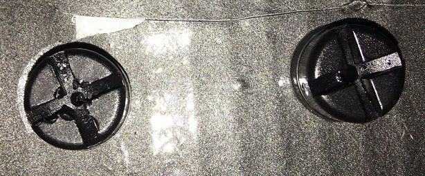

Here is the damaged head that had me looking for a replacement. The new part is on the right.

hi yes your post was the one I was referencing. Thank you! In the photos it appears that the thread size appears slightly different or are my eyes playing tricks?
Old Apr 6, 2025 | 10:26 AM
clubairth1's Avatar
Community Influencer
Posts: 12,094
Likes: 3,368
From: home
I checked it every way I could. It seems to be identical and it works 100% in the radiator. I have been running it for several thousand miles now.
