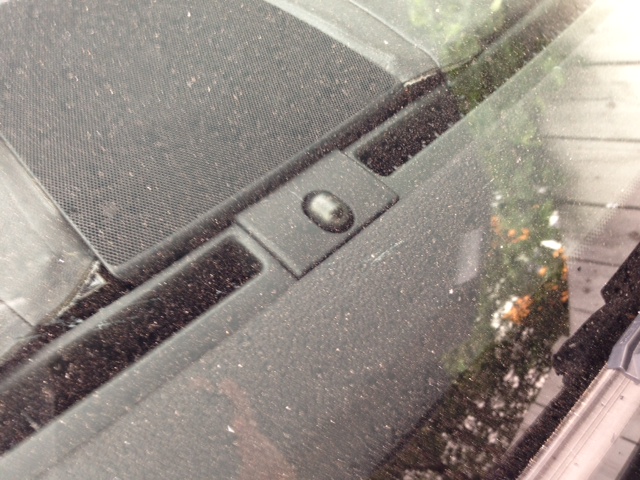

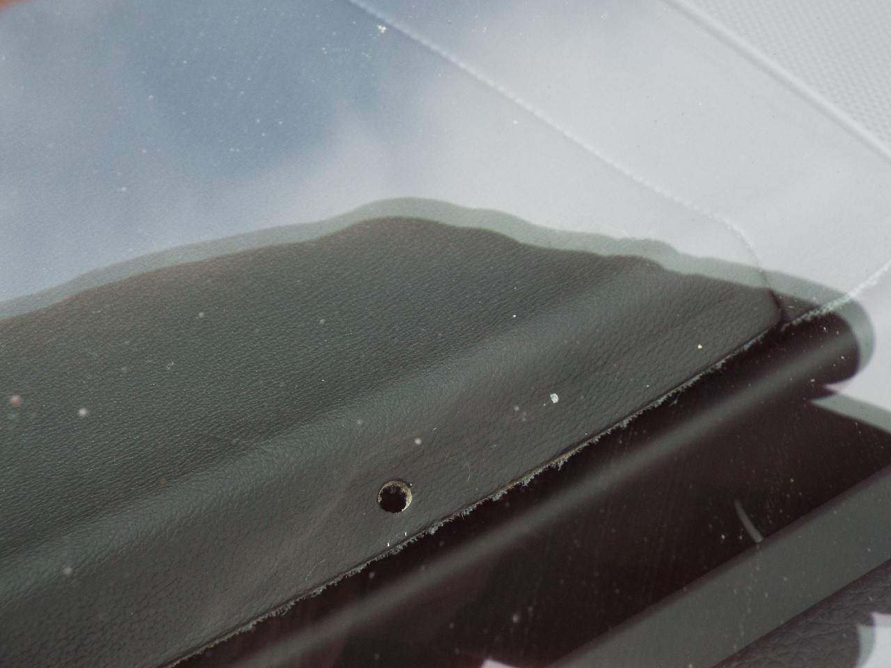

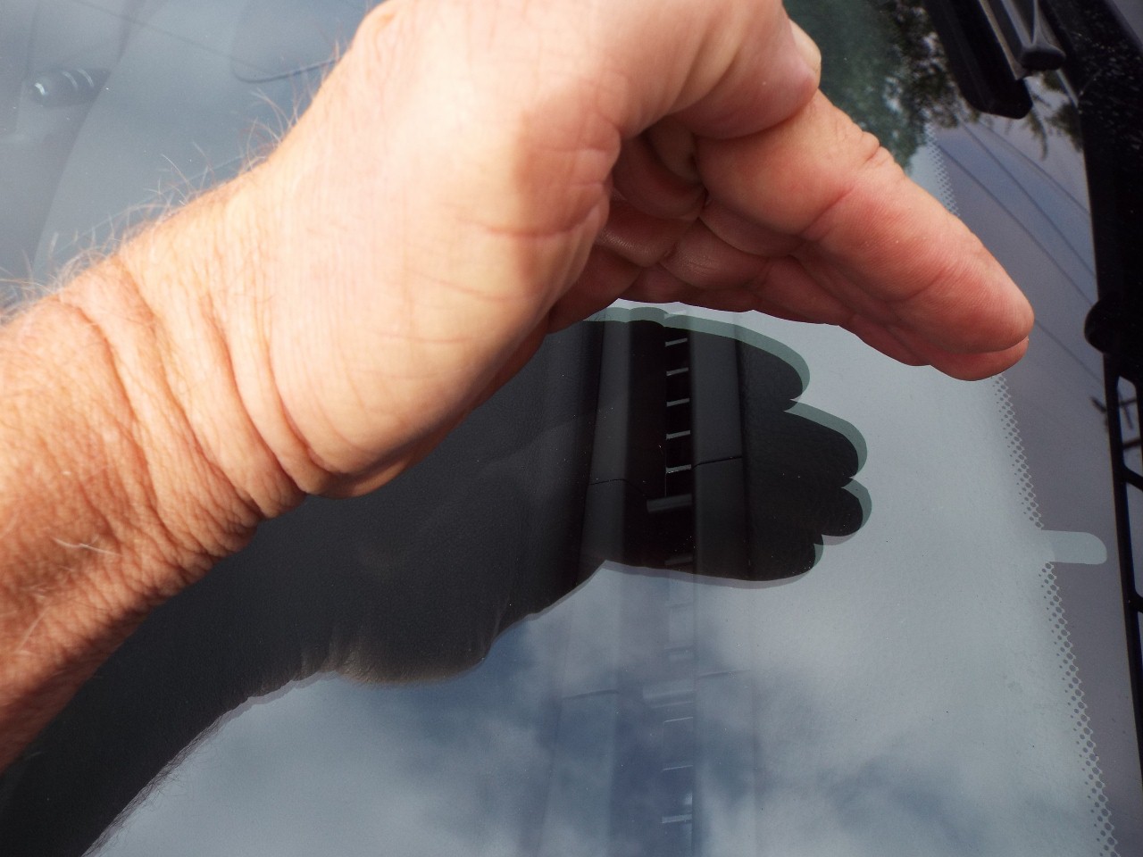

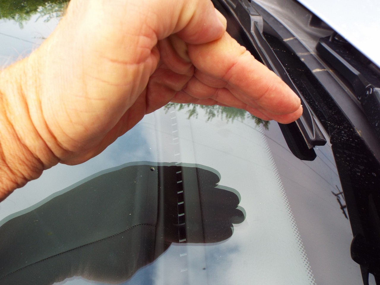

Okay, so attached are a couple of photos taken from the outside of windshield showing where leather has lifted, first of an area showing the raw edge of the leather and then of an area where it is still attached. As you can see, there is barely enough leather to wrap around the edge, and to ask that a tiny bead of glue hold a tightly stretch leather cover through hot and cold contraction and expansion is ridiculous. Staples would have prevented (and are now preventing) this from happening. Even an extra 1/4" of an inch of leather most likely would have prevented this situation. Once there is no adhesive holding the edge, the leather is free to contract and create the rippling a.k.a. "shrinkage." This is nothing more than a penny saving exercise by Jaguar and is inexcusable. I have photos from inside but the bubbles and stretching are not visible enough to the camera to show up, so I didn't include them.

I wouldn't be happy with picture #1.
Thanks for posting.

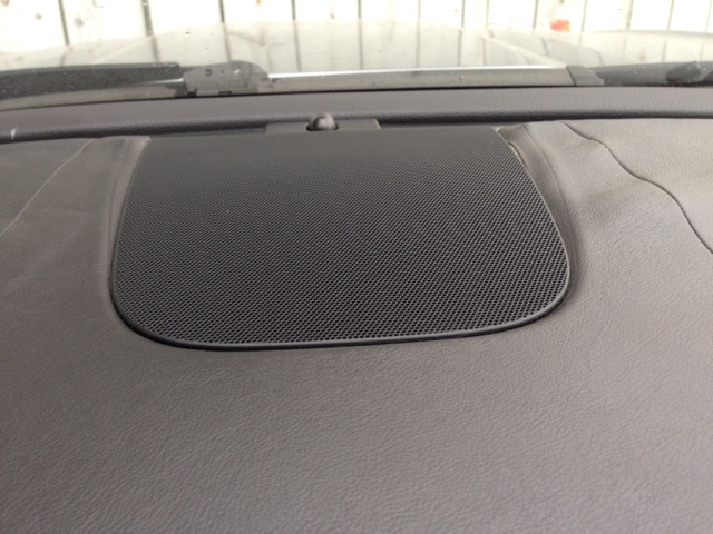

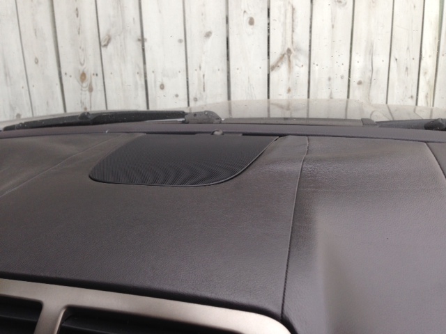

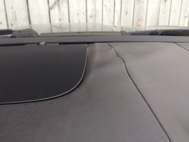

I feel your frustration! I have an 07 XKR with the same problem. I've contacted Jaguar NA and was told there is nothing that they can do about it. The dealership quoted my a price over $3800 for a new dash and install. It's ridiculous to have this problem for a car of this caliber. I'm wondering how many owners have had this problem and is there a way to find out? I'm sure hundreds unreported as well. This really sucks!!! Attached are some pics I took.

A special interest group needs to be formed to address this design defect. If a group of twenty or more members approach Jaguar with this problem they may get Jaguar to supply a new dash to replace the ones that have gone bad. Some owners seem to have been successful in getting Jaguar to take 50% to 100% financial repair responsibility.
Wow, I'd like to thank everyone who posted pictures. The adhesive failure really puts a stain on the car. Everyone who has not experienced this problem needs to be aware of it and of what Jaguar is doing about the design defect. In 5 years or less your dash could look like one of the pictures simply because the adhesive aged and failed. A lot of members on this forum plan on keeping their cherished cars for a long time. It is obvious this is a design defect of Jaguar using an unsuitable adhesive or method to laminate the leather on to the dash.

If you stretch a 2" rubber band around two nails spread 4" apart, it will easily stretch around them. If, however, you remove one of the nails, the rubber band will retreat to 2". It is no different with the leather. If the adhesive fails to hold the approximate 1/16"-1/8" of leather at the very lip of the upholstered dash board, the leather "shrinks" back to its original size. There is nothing to hold the tension of the stretched leather once the glue has failed.
