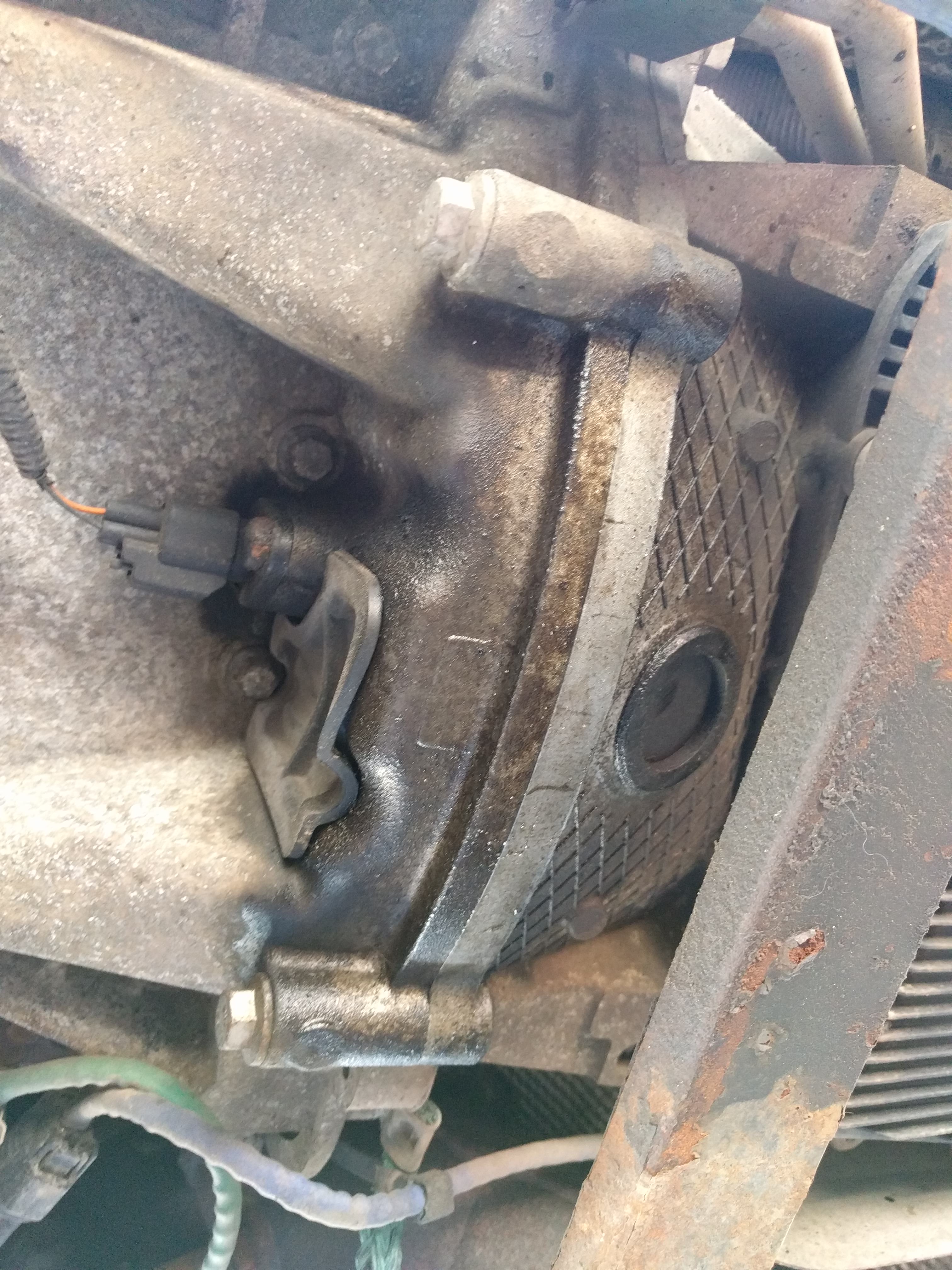

While looking underneath the car, I noticed a minor leak at the back of the engine, in the area where the crankshaft position sensor is. Pic attached.
The leak seems to be originating from the bolt, left to the crankshaft position sensor. Opening up the rubber seal below it (which gives access to the flywheel), the flywheel is dry and there is no sign of oil on the flywheel. It seems that the oil is dripping by the side and with the car movement is then dragged on the gearbox enclosure surface side.
The Jag technician has cleaned the area, asked me to drive it for a couple of weeks and get back to him to see whether the leak is still there and to what extent, in which case the bolt will be removed and reseated with a sealer to it. Seems like a reasonable approach to me.
Anyone of you ever encountered such an issue? What might have caused such a leak? Could a recent oil change have played a part?

Doing some more research, mostly here, I think the possibilities are as follows:
1 rear main seal (I'm finding this difficult to accept); would this show as oil splattered all over the flywheel?
2 seals between the various engine block components inside the flywheel housing;
3 the hex galley nut on the engine side inside the housing; (see thread https://www.jaguarforums.com/forum/x...leaking-38555/. It's not an XKR, but the engine seems to be quite similar;
4 are the two circular things just below this nut, plugs which could leak?
I suppose the transmission needs to be removed Any estimates of time to do this?
so not looking forward to this ....

Update:
Car at dealer; transmission removed. Have been informed that leak is coming from ... wait for it ... the hex plug in the cylinder block on the engine side, on top of the rear main seal. It seems that there's a slight leak here which is dripping on the engine side of the bellhousing, making it's way down. As mentioned in 'Option 3' below, although it's not the same car and the plug may not be 'loose' but the seal leaking. Rear main seal is ok, thank god for that!
Plug and sealing washer will be replaced.
Removing transmission is not trivial; needs removal of cat converters, exhaust system, draining of AC refrigerant, removal 'R' exhaust vacuum pump, etc. A couple of days work at dealer.
Of course, I'm taking this up with Jaguar as I don't think that this should really be happening.
I'll be going to see the car in surgery tomorrow, take some photos and post.
Any ideas of why something like this would happen? Maybe lack of previous owner use?

Car back from surgery. Plug seal replaced. Photo of interior of housing and culprit plug attached. Works done well; case closed.
