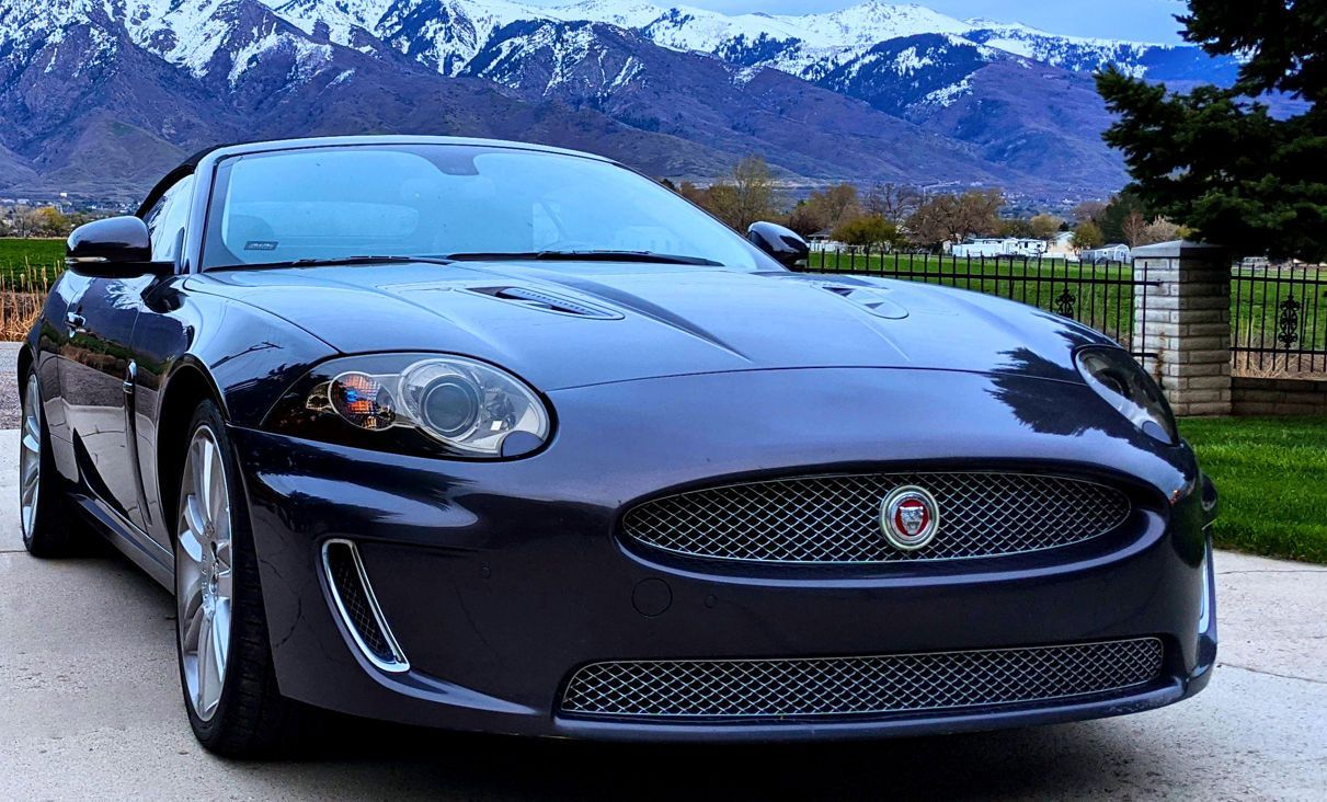

I have tint on my headlights, I'd not want to go back to plain. It's only 10% tint made specifically for headlights. It's thicker and bends easier and sticks better than window tint. I've had it on for probably eight years, zero problems whatsoever.

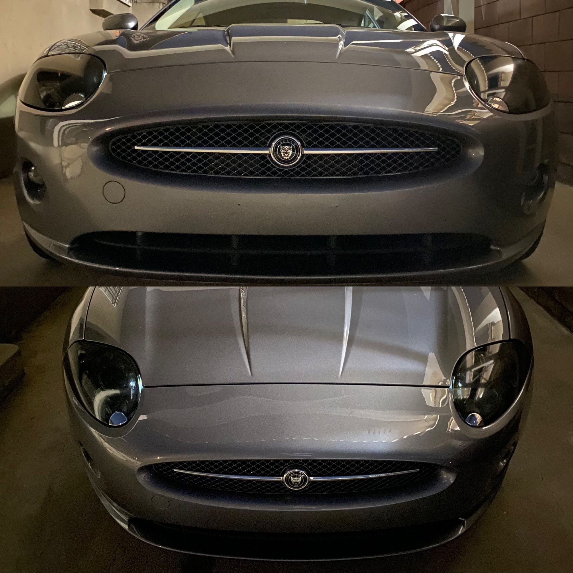

Old Apr 20, 2025 | 11:46 PM
indyx358's Avatar
Joined: May 2020
Posts: 228
Likes: 143
Default Pictures - Eye Sore Gone For Now
So here it is folks, final results after tinting the headlights. The winds were terrible by my house that I wasn’t able to work on it myself and I couldn’t wait any longer so I found a guy in my area that did the work for cheap! Let me know what you guys think.
