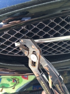

Upper Grill:
1) Take a pair of strong pliers or channel locks and grab and twist the Ford Taurus bar off the grill. Yes you will have to destroy it to get it off. Use gloves because the broken edges are very sharp and will cut you...ask me how I know. When you get to the mounting areas you will need a needle nose to rip it apart so it will be small enough to push through the grill and just let it fall behind the grill.

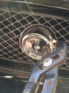

2) Center Growler emblem will need to be destroyed as well. Small blade screw driver will pop off the growler then grab it with the channel locks and twist it off with force.

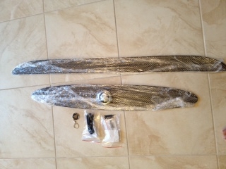

Having trouble attaching pictures now.....hmmm
"Growler"
Attached Thumbnails Mounting Mina Grill-cid_7d28c24158b8408a9a35e3bfa00664a5%40brent.jpg

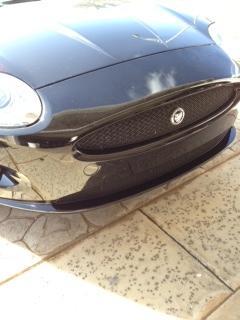

Hope this pic works now...

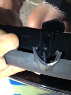

Thanks for the old post Hawaii, you were spot on!! I did both my grilles yesterday, I didnt bother with the C brackets for the lower grille just the screwed them to the virtual posts.
Close up of them for anyone looking to do the same thing.

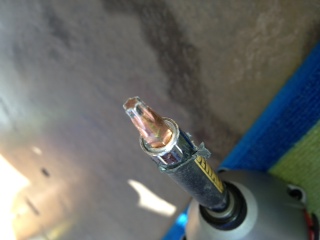

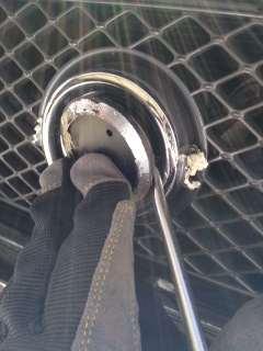

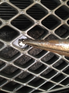

Just installed the Mina Gallery grille and was quite frustrated at the thought of destroying the emblem and just ripping it out. So what do you do?? Find yourself a nice girlfriend buy her chocolate ice cream and then ask her to delve her hands deep between the hood and nose of the Jag and unscrew the clips (not quite bolt as they just take a twist and they are off). Installation requires further persuasion to once again play around, this time we used transparent tie straps at each end and believe me it holds wonderfully and the best of all, the original can be retro fitted if so wished.
