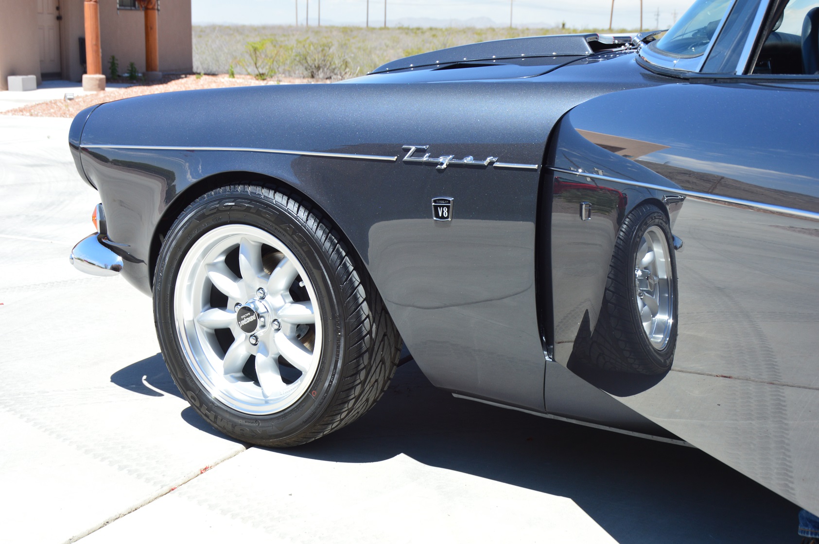

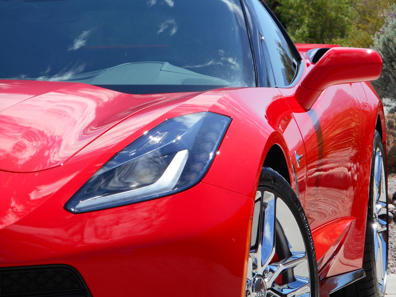

Here are a few images of my sports cars and also a few of a Classic British car, a 1965 Sunbeam Tiger V8 that a club member paid me to detail the car with a ceramic coating. The Sunbeam took 6 to 7 hours to complete as well as the other cars.
All of my vehicles and the Sunbeam have been hand washed with Dawn to strip off any oil, tar, etc, and a "polymer fine grade" wash mitt was used. The cars were hand washed again, dried, and then polished with a prep polish. After the prep polish using a DA (dual action) buffer, each car was wiped down with a solution of 70% isopropyl alcohol and 30% water to remove any polish residue. Then the final step is the application of the nano-ceramic paint coating.
The shine and reflective qualities are easily shown in the images. While the images look great, seeing the vehicles in person is absolutely stunning. I have completed many other vehicles using the same method for many other customers.
1st is my 2015 Corvette C7...2nd is the 1965 Sunbeam Tiger V8
Click the image to enlarge.....click again for full screen.
More to follow in next post.

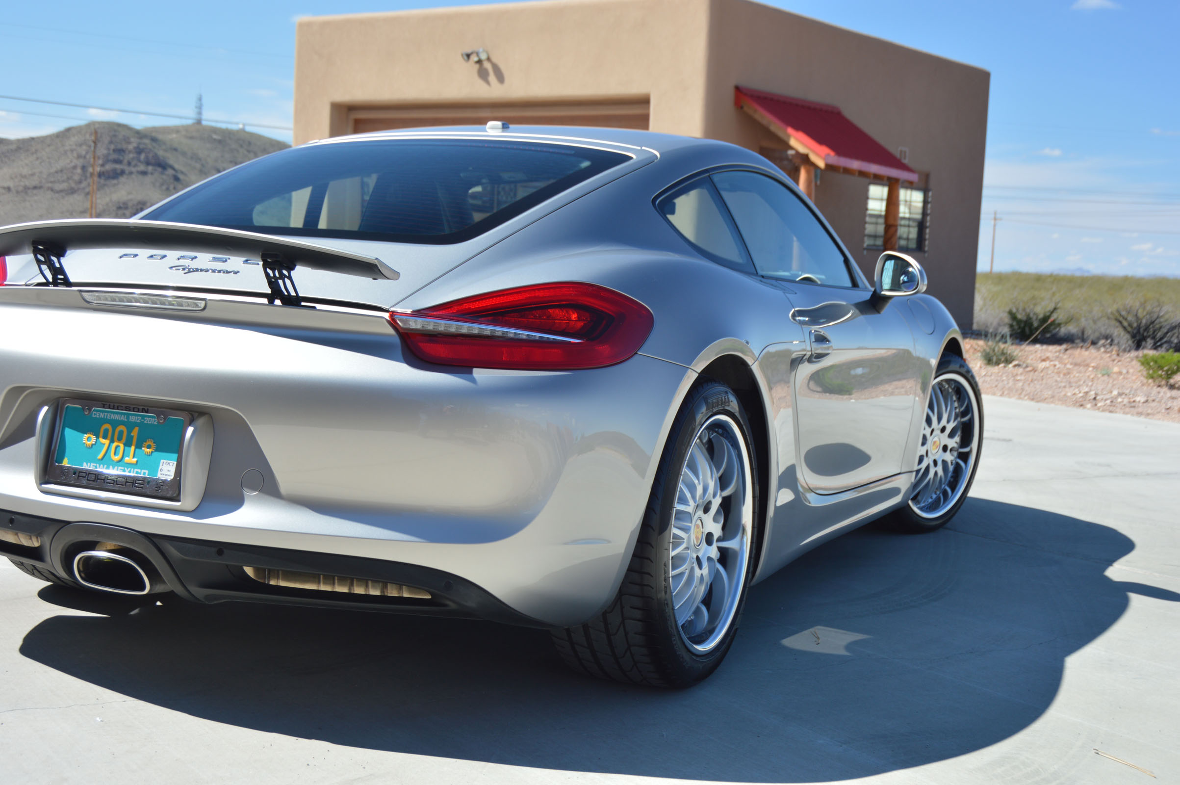

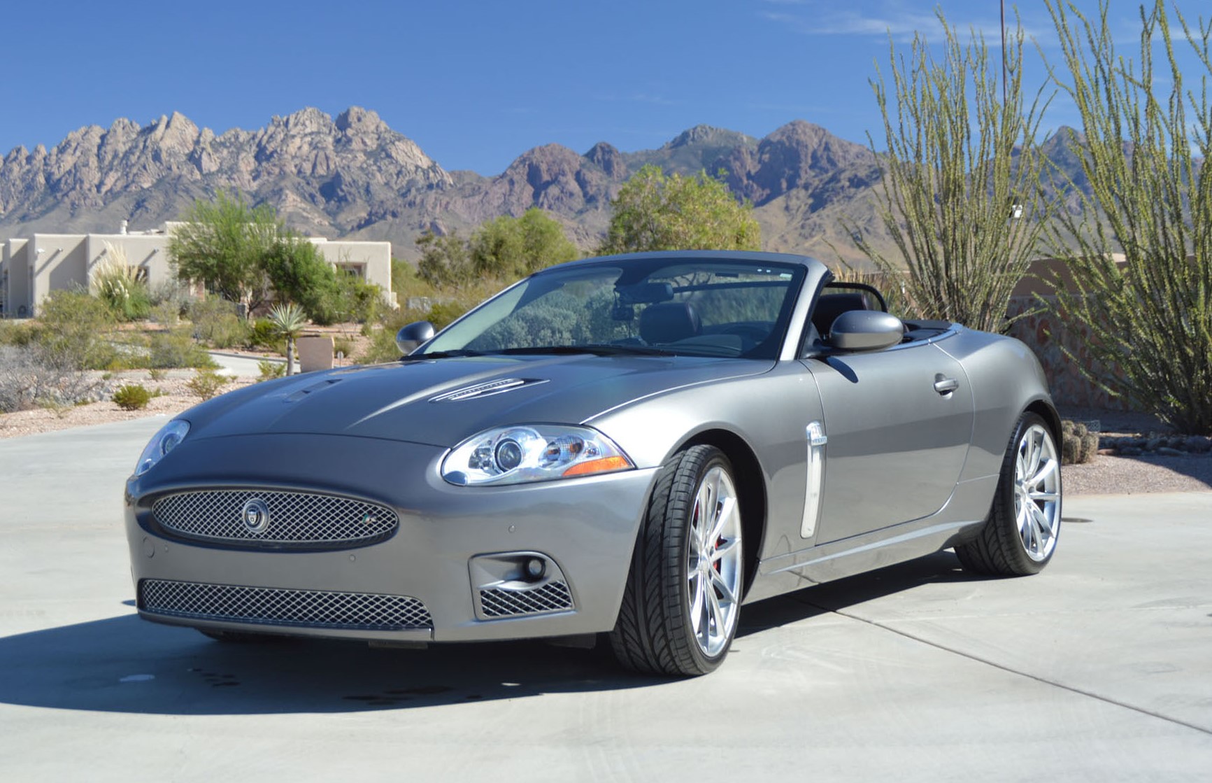

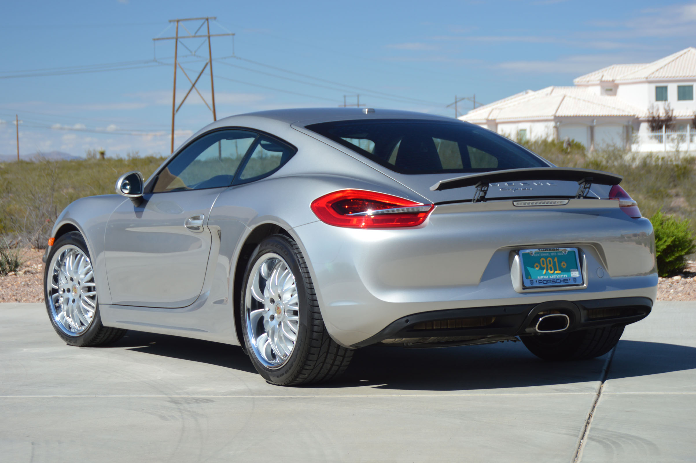

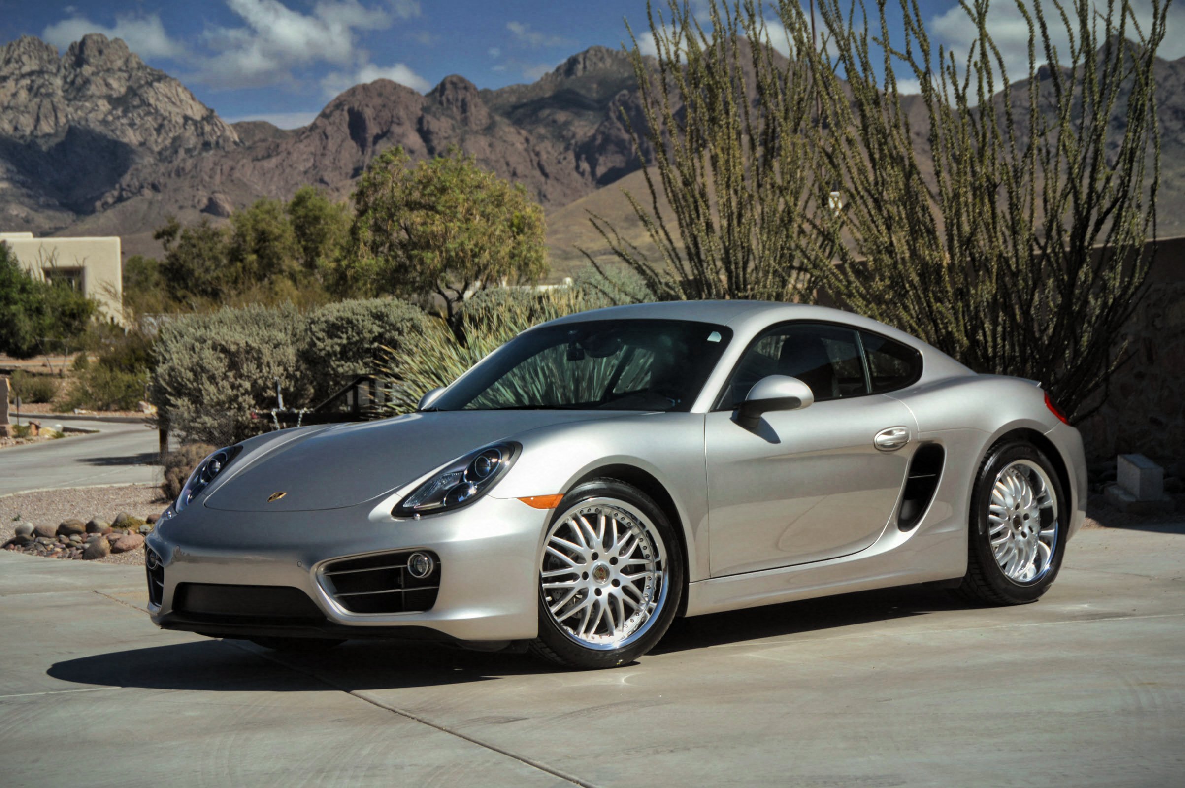

More images of my 2014 Porsche 981 and 2009 Jaguar XkR which was recently sold.
Once again, both detailed with the same method and a nano-ceramic paint coating applied. The Corvette was detailed with the ceramic coating 2 years ago, and looks the same today, simply stunning in shine, and reflective qualities. I will detail the Corvette again in 12 months.
I used the Pinnacle Black Label Diamond Paint Coating on all of the vehicles. Here's a link to the product. Sold at Autogeek.net and shipped from Stuart, Fl. One bottle will complete about 5 cars.
I cannot stress the overall quality of using my method and ceramic paint coating for superior results to any fine automobile. You can not realize the quality until you actually use the product.
In addition to the ceramic paint coating, all the glass was polished and ceramic coated using a ceramic "glass coating". Same with the wheels, I used a ceramic "wheel" coating, which really repels brake dust.
After the cars have been "ceramic coated" there is NO need to use any wax product of any kind. These cars have never had any wax product applied to them after the ceramic coating has been applied.
While the detailing project may take a single person 6 to 7 hours to complete, it can be done in steps over a few consecutive days. Just be sure to cover the car after each step, until you move on to the next step. This is a great weekend project or a 2-day weekday project, that provides stunning results for the car owner.
Click the image to enlarge and click again for full screen.
