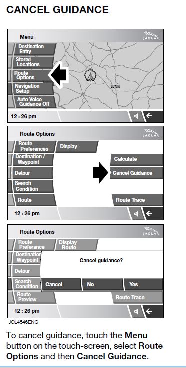

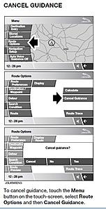

Do you mean cancel guidance? If so have you seen the attached instructions in the handbook?

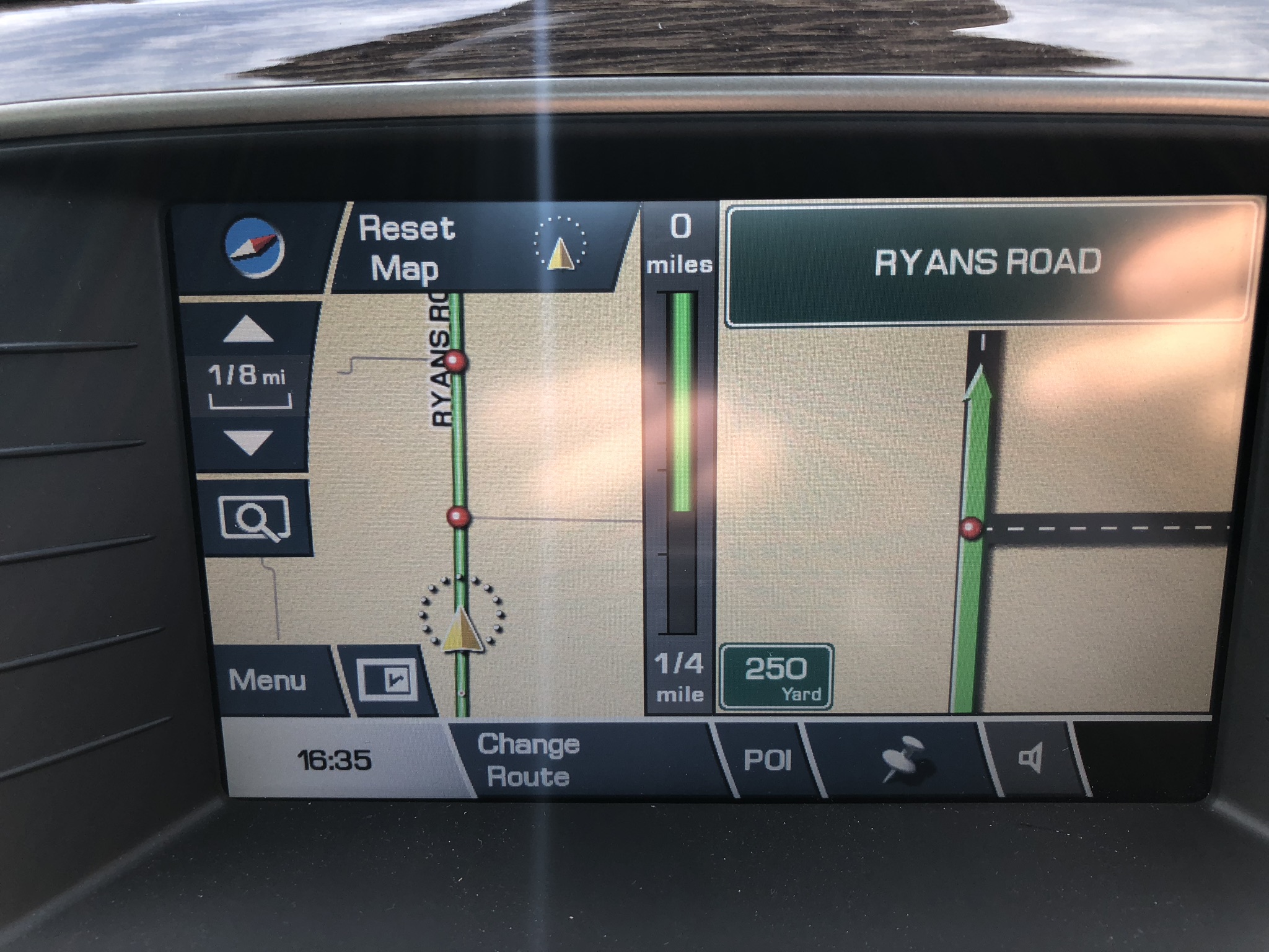

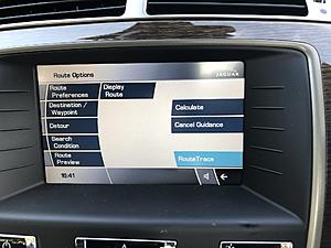

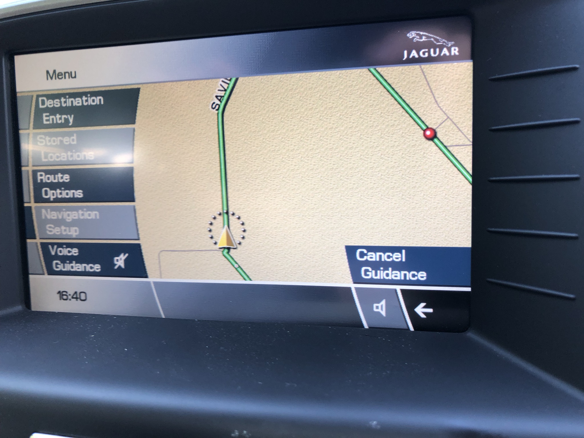

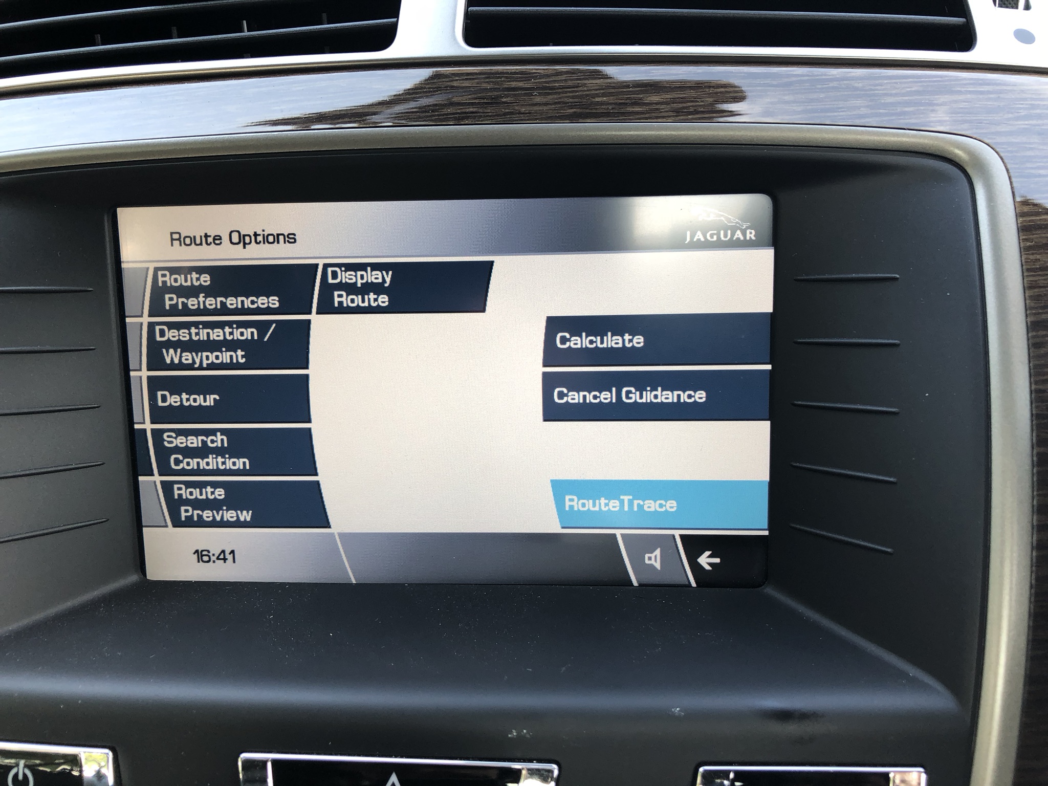

Originally Posted by Rick'sJag
But I need to shut off the engine first. Not convenient. Passenger can not operate it while the car is in motion.
Worst case you should just have to pull over but on both my '07 and '10 XKR I could cancel guidance while moving.
Other options were greyed out unless I was stationary but, I have just checked, and on my current one I can tap on the map which brings up a button that says Change Route and if I select that I can cancel the guidance from that screen as well.
Are all the options greyed out when you press the menu button on yours while you are moving?
Attached Thumbnails Nav unit problem-navmenu.jpg   Nav unit problem-maptap.jpg   Nav unit problem-maptapoptions.jpg
