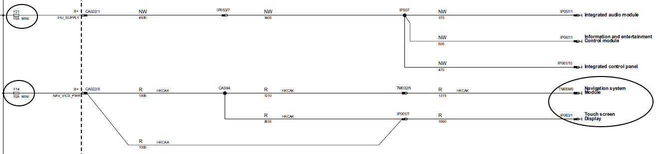

John, I would first make sure the battery in your car is fully charged. Partially discharged batteries can wreak all sorts of havoc in XKs.
Then I would check the fuses that protect the navigation system and touch screen display circuits. The Electrical Guide for your MY indicates that fuse 14 in the fuse panel between the back seats is the one. I would also check fuse 21 in that panel. See below.
Good luck.
