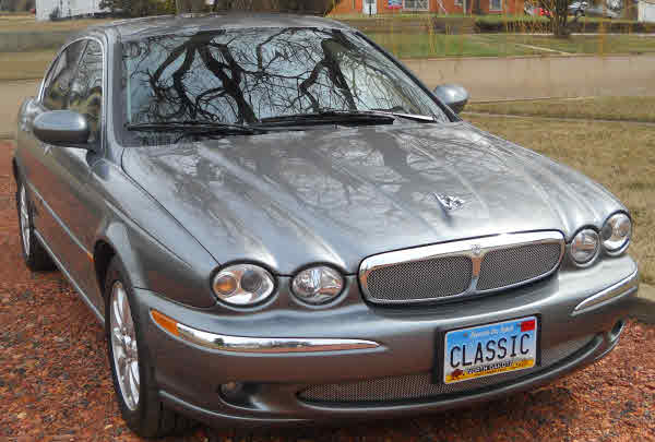

(After you replace the upper and lower grille with the Mina mesh inserts, all of these cars look like an '08 in any event!)
This is an '05 with after-market grille set
This is my '02 with the same grille.
