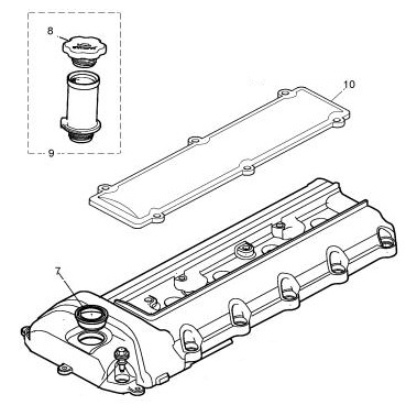

So we are definitely talking Oil Filler Cap (item 8) on a 4.2 litre engine:
The leak must be coming from either a damaged filler tube or Valve Seal (item 7) in the Camshaft Cover. A temporary fix can probably be made with silicone after cleaning off the oil but it looks like replacement parts are inevitable.
I've never had to remove the filler tube on a 4.2 but it look as if it screws in rather than being a push fit ........?
Attachment 118086
The filler cap screws in and there is a silly clip holding it in so it does not screw out. People won't see it as the leaking oil covers it. Some diagrams have a gasket below it some do not. Can you tell me where you got this diagram or the part number associated with the gasket at the top of the manifold that goes on the bottom of the filler tube. That is where these leaks come from.
