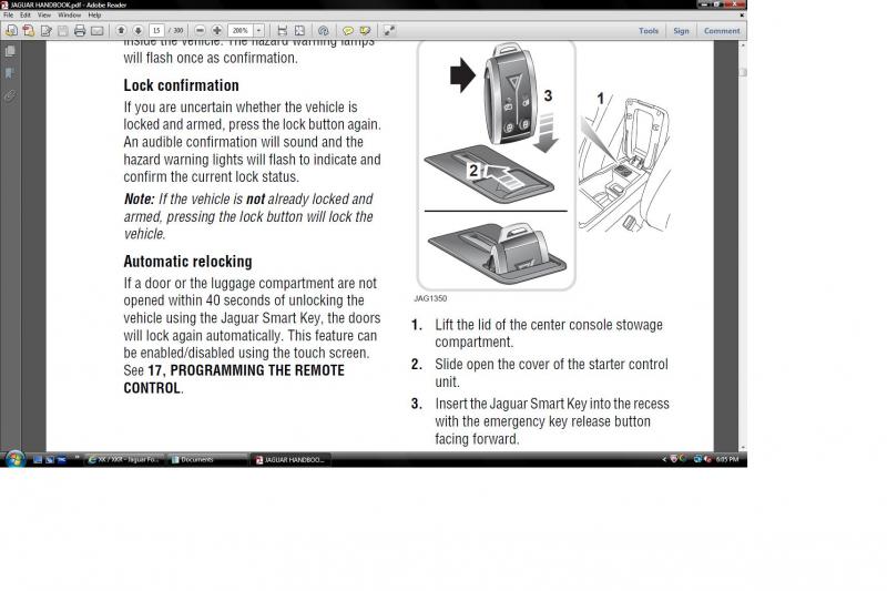

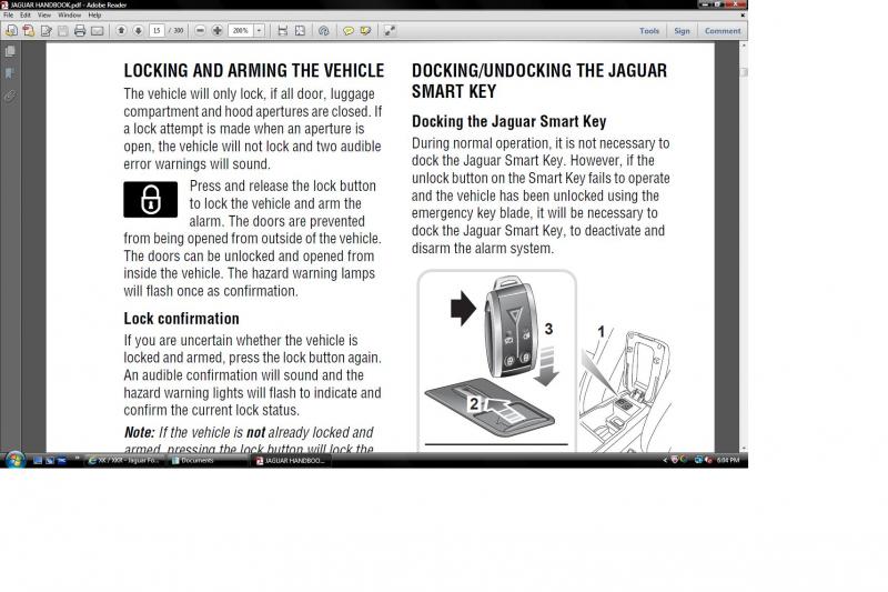

Any small chance the key fob needs to have its battery replaced? Mabe carry both fobs with you and try each.
I had something similar happen to me four or five months ago. Visited my brother and when leaving the start button did zip. I don't think I had locked the doors prior to this.
To get the car to start I put the fob in the armrest Smart Key Dock and started it that way.
In fact if you have not already tried this, maybe the next time put the Smart Key in the dock and start or try to start the car.
Sad part of this is that when I got home I turned the car off and then started the car numerous times using the same fob without changing the fob battery. That said, if I were you I'd try that Smart Key in the Dock next time it happens and see how it goes.
I'm not too sure how this would work out if the car had been locked up and the door would not unlock. The part you mentioned about how your door opened but the window did not come down the inch or so it normally does caught my eye. How hard was it to get the door open without breaking the glass??? I'm not going to try this on my car 'cause I'd probably break the glass. I guess there is enough 'bend' in it to get the door open.
Attached Thumbnails Nearly total electrical failure-smartkeyone.jpg   Nearly total electrical failure-smartkeytwo.jpg

New fob battery, but I hadn't thought of trying the fob dock, thanks! If or when it happens again that would be a great data point or possibly cure.
