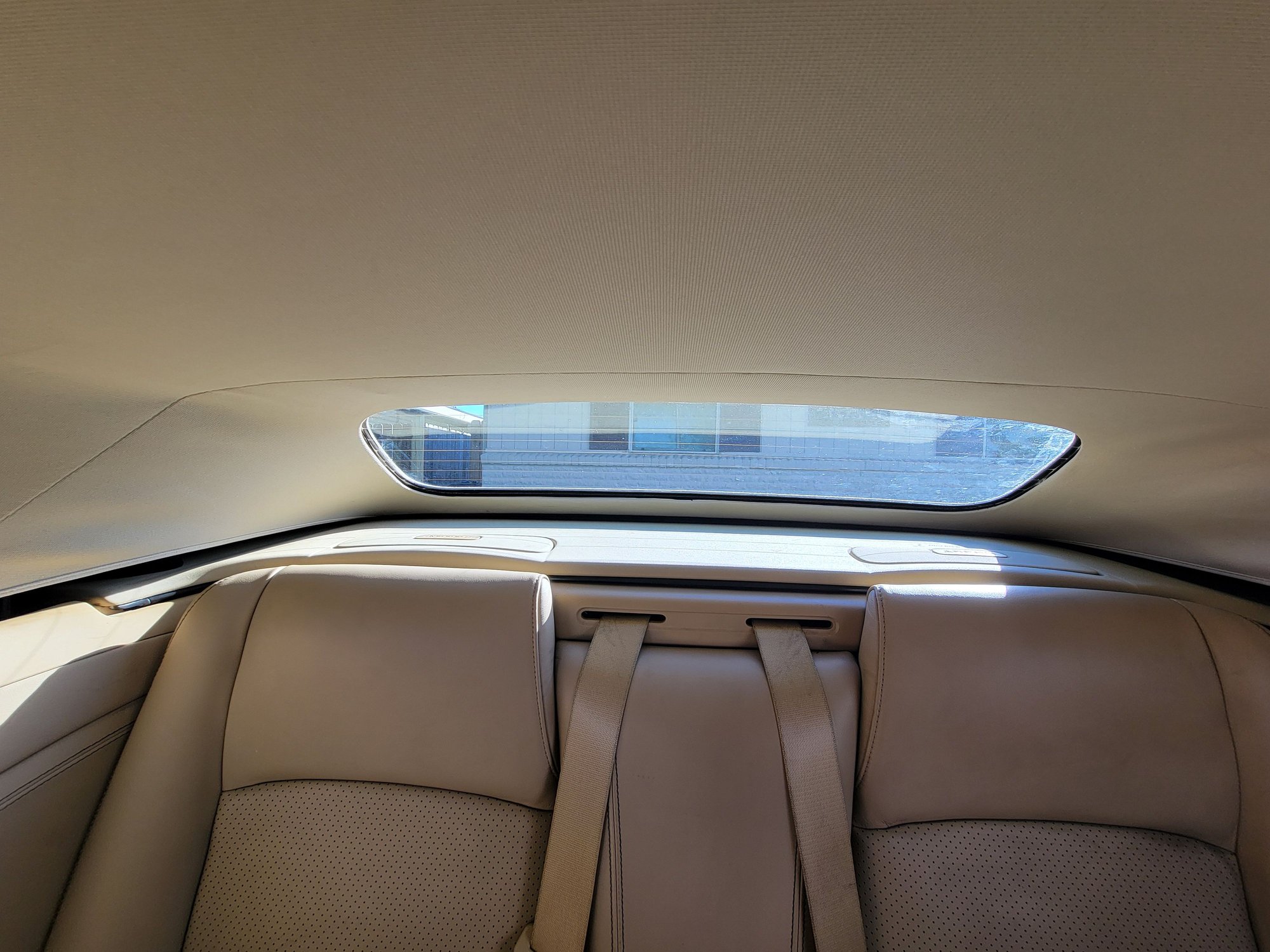

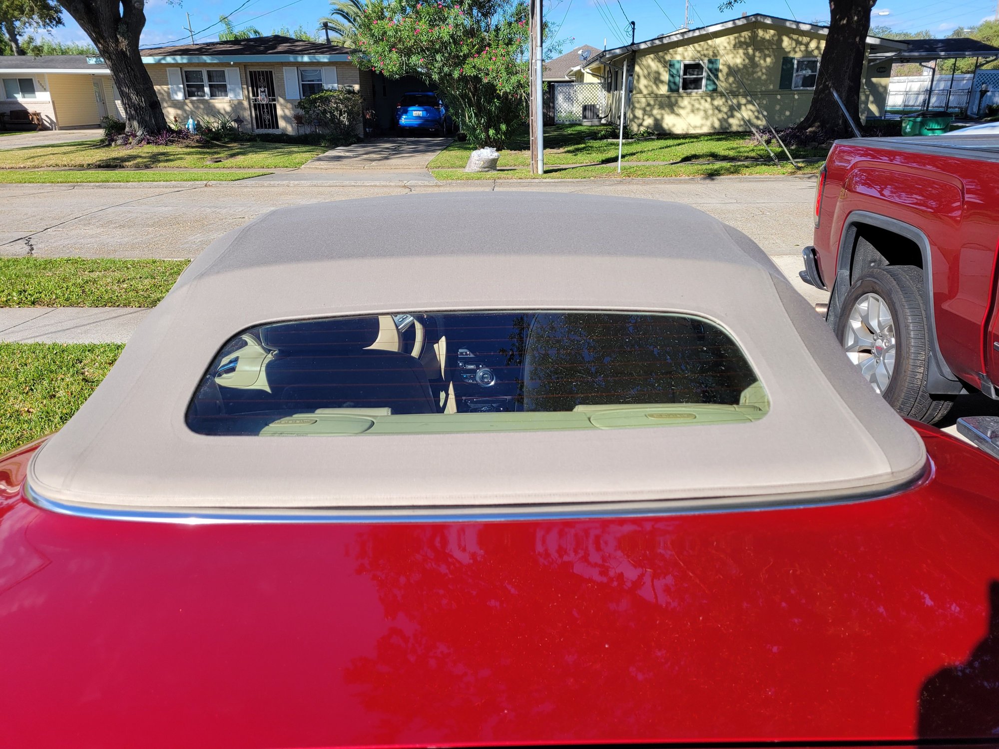

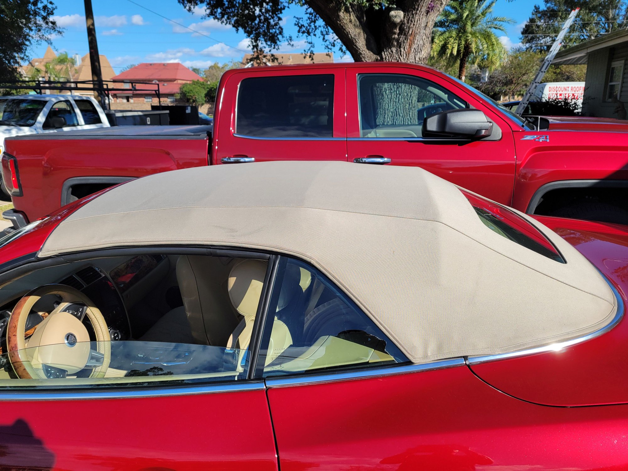

It took a little while mainly based on my schedule (and my son's) but the top, cables, and headliner are replaced,
The headliner along the sides along the trim work is not as close as I would like, about a 1" gap.(will continue to work on that.
I still may tweak the outer cover at the sides to make them slightly tighter.
This was probably the toughest part of the installation trying to keep it fitted tight and "pop-riveting" the carrier and the outer cover to the frame, took three attempts.
The final closure at the rear was also a little tough to stack the headliner, the retainer the outer cover, and the final retainer/weather stripping, that took 2 times.
The weather seal from the outer cover to the rear weather seal is a finicky attachment in a curve, so it was just cumbersome to get it into place and maintain the attachment.
I've managed to get great support from a GAHH Support Tech on a couple details.
I did make one significant mistake (not critical) with mis-locating one strap that pulls inward to create the fold as the top goes into the compartment,
Since I have opened and closed the top several times the fold is sort of "remembering itself" and is less of an issue.
But I have a couple of possible solutions.
Waiting for the RaggTopp kit to come in but got the brush and it really works a lot better than the "horse hair" type brush.
Every one have a Great Thanksgiving,
