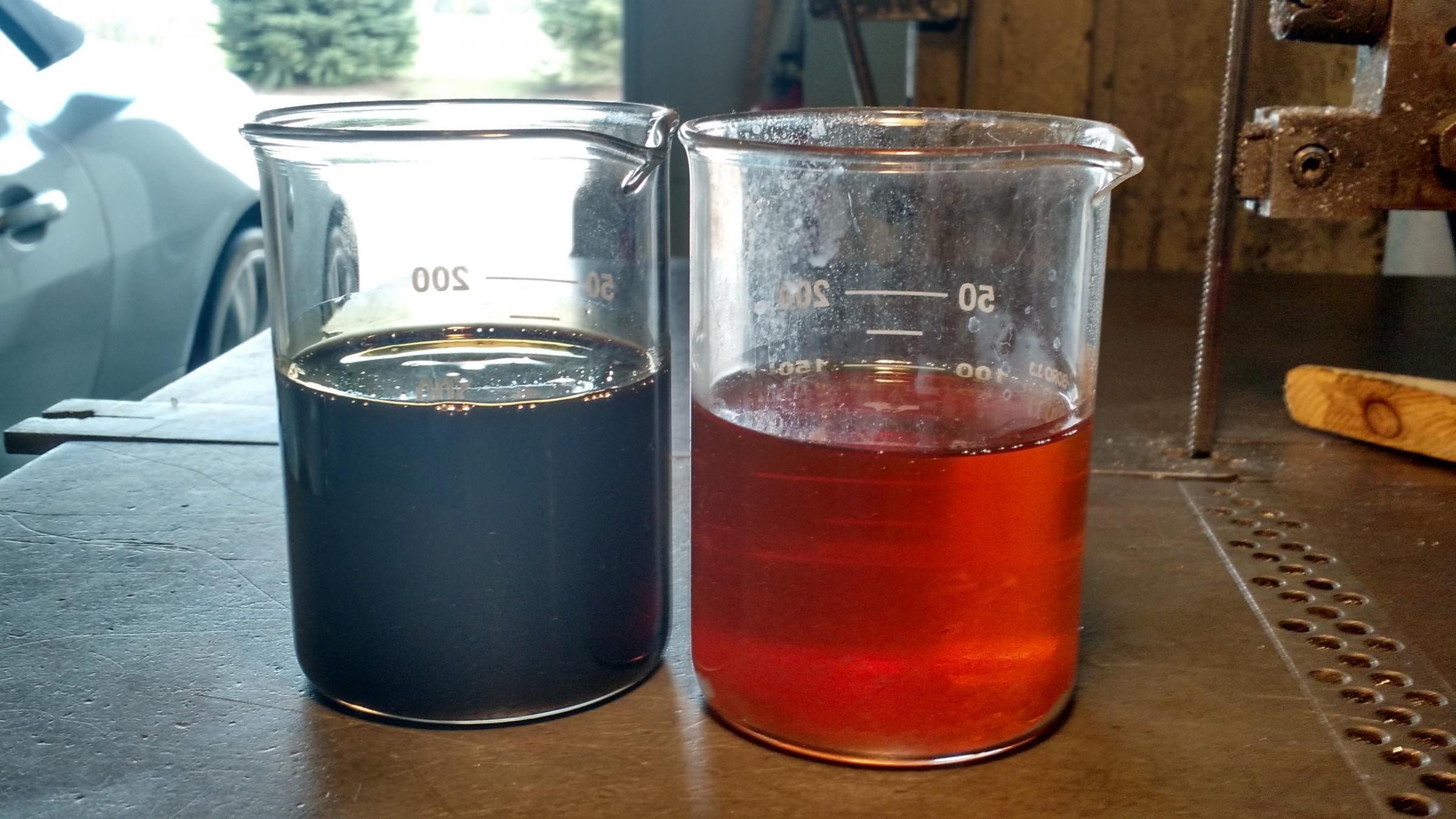

Performed the change this evening and took a pic of old vs new. New is on the right if you couldn't tell
When I got the car, the oil on the dipstick was so clear it was hard to read. Not that it was black on the dipstick when I changed it. It was the more like the color of the new oil, actually lighter than that. Just cause it looks clear doesn't mean it is. Your looking at a thin film on the stick which would appear more transparent.
I had the receipts from service and the oil was changed at 37,600. I did my change at 43,000. Talked with the owner of the indy shop as he had done some other repairs and took my car in as the blower motor wasn't working and they were replacing for me. Asked about the oil change as the receipt only said full synthetic oil change and he said they used Mobil1 and there was a Mann filter installed.
I guess I could send off to lab and see what they say and may do that, just have to look it up again, I know it's here somewhere.
