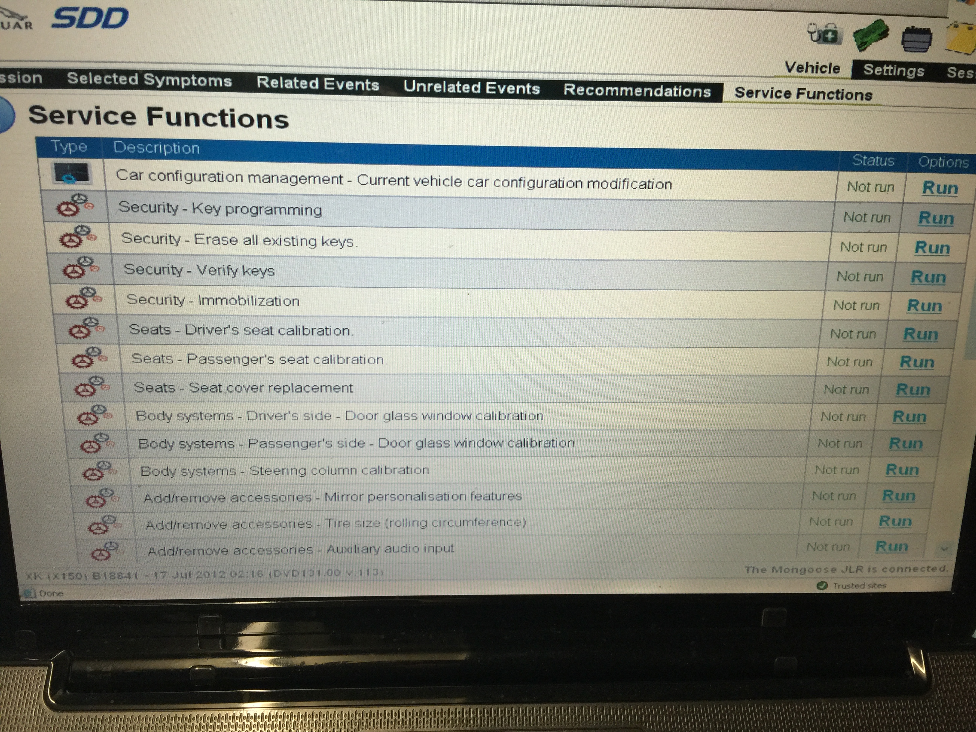

My passenger seat will back will not sit up correctly. It appears to only travel about 1/3 of the driver, leaving the seat and passenger leaning back very far.
I have done several searches, and what I have gathered is the dealer will have to reprogram it.
I loath having to go there and have not found any indy in my area that has the diagnostic tools.
Anyone have any other suggestions?

There is a recalibration process done through SDD, the software diagnostic tool. Not sure if this helps but maybe if you set it to a possible extreme position/back inclination, and then disconnect the battery and reconnect it, it might find its way back? Haven't tried this myself, though.
I have had my Mangoose (Chinese clone of a Mongoose) for 5 or 6 years and have been able to do most things dealers do, including updating firmware in various modules.
As ejjbee said and as you can see from the attached screen shot the seat calibration routines are in one of the menus.
If you have a spare laptop, you can get set up yourself for as little as $50.
