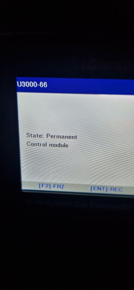

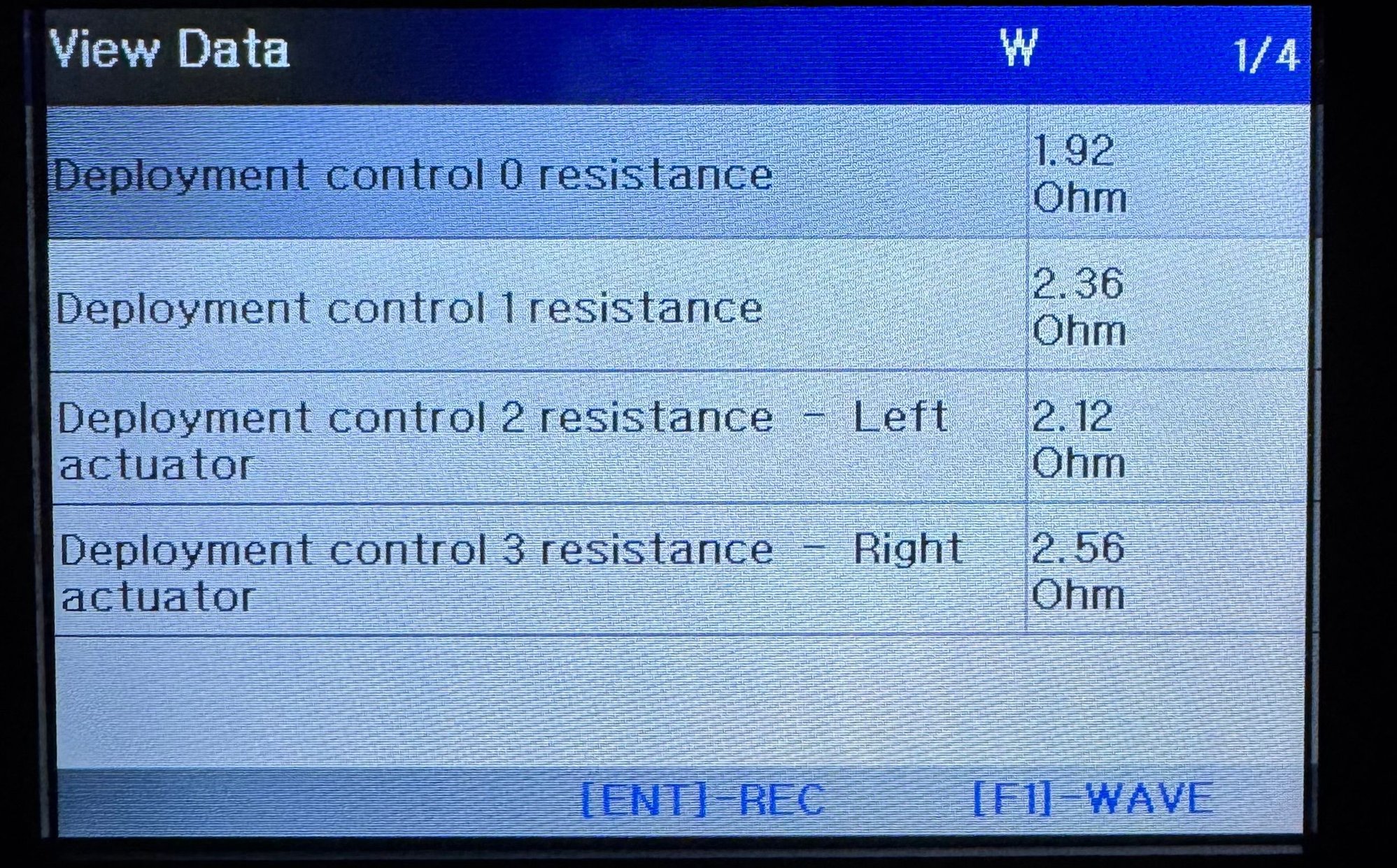

I’ve got the pedestrian warning light on the dash 2008 XKR cab. I’ve read the posts and can see there are two sensors at the front cross member low down that I’ll have to remove the slash Gaurd. Plus two at the rear of the bonnet/hood. I’ve scanned with icarsoft and I get U-3000-66 and the attached resistance values
Question is is there anyway to tell if it’s the front or rear sensors?

Thank you for the reply and apologies for my haste in the question I could have described it better. I have read 501-20C and there are specific DTC codes for each of the sensors in the pedestrian system. I guess my scan tool isn't sophisticated enough to give the specific DTC code and sensor at fault. It just shows U-3000-66 and when I click on 'show error code information' it gives the resistance values of four sensors. I'll have another root around the scanner to see if there is anymore information before I start ordering.

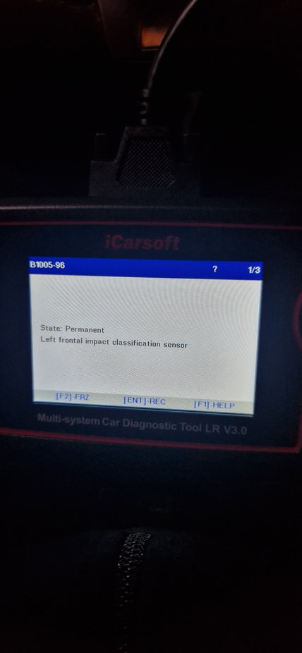

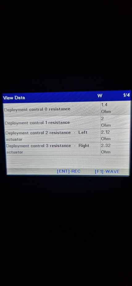

Hi, I've plugged the scanner in and cleared the codes, the pedestrian sensor warning comes straight back on, i did read somewhere that if the light comes on after a 100 times it stays on all the time? it has come on more than 100 times for me I believe..
does this mean that the module is 'full' and i need to get a new one, or if I replace just the sensors the error will go away?
for reference this is the info I pictured from the scanner.

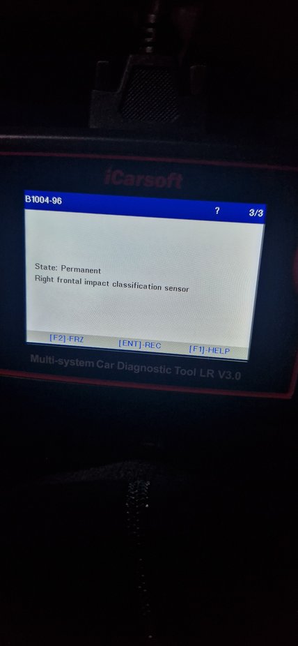

When you do the autoscan you will get the results, scroll down to 'ICS', press enter,
it might ask set ignition to ON, i pressed the F1 key, scroll down to 'read fault code' press enter, you should have the information you need, i had three pages, lh sensor, rh sensor and control module, now I've replaced the sensors I only have the control module fault now.

Finally got round to replacing the two sensors (with new) at the front. The icarsoft now says left and right sensors are at fault great!. Plus says module is in permanent state. So in answer to my original question the icarsoft can identify a faulty right or left sensor. I will look for someone with ssd software that can reset the module.
