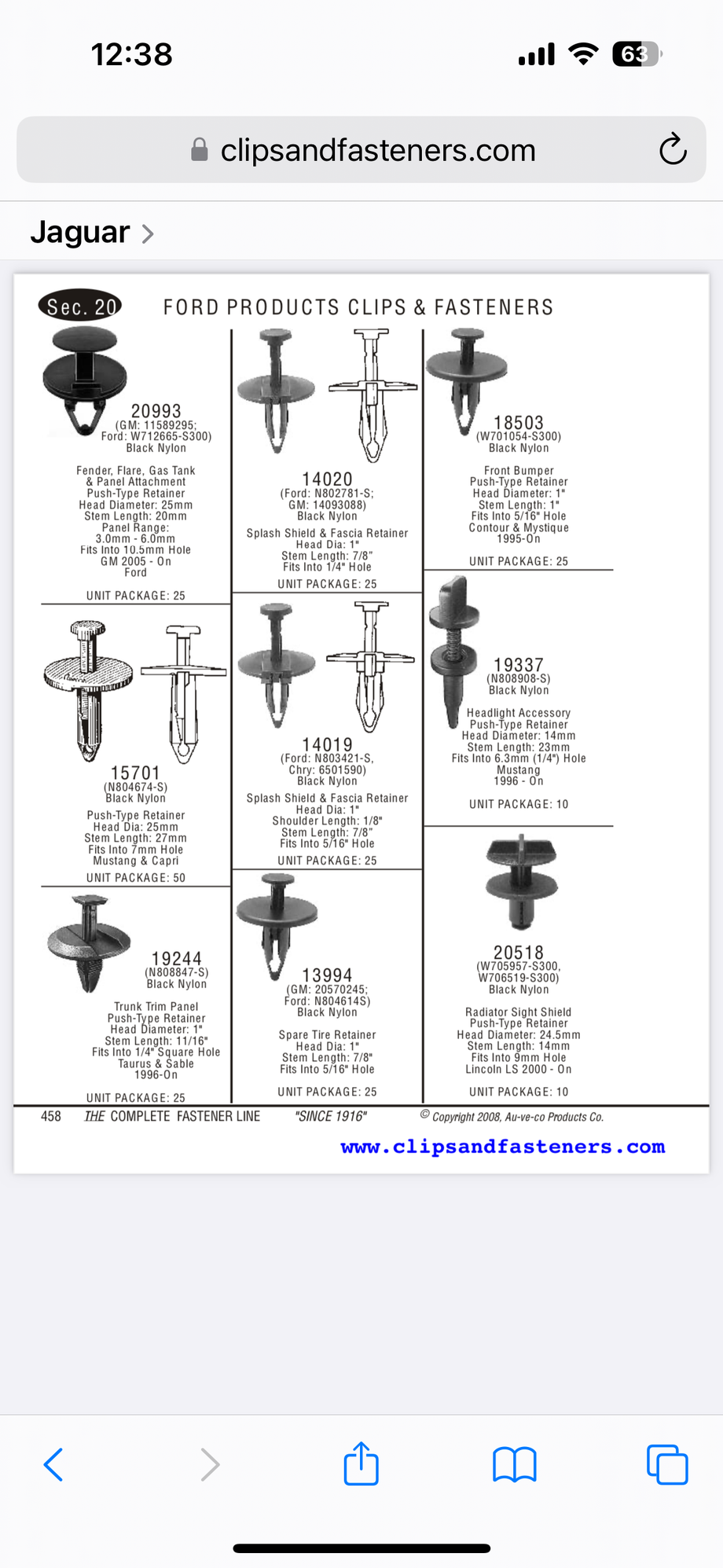

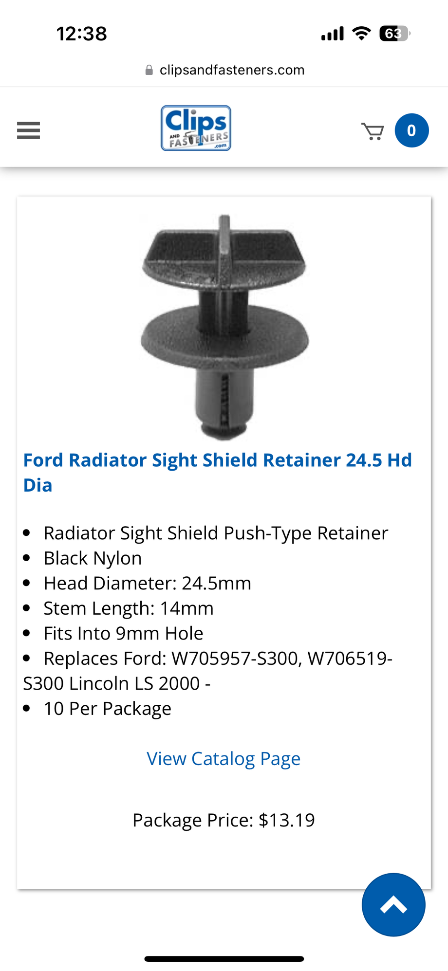

For the plastic covers, go to clipsandfasteners.com and search for their part number 20518:

Thank you, this is what I was looking for.
