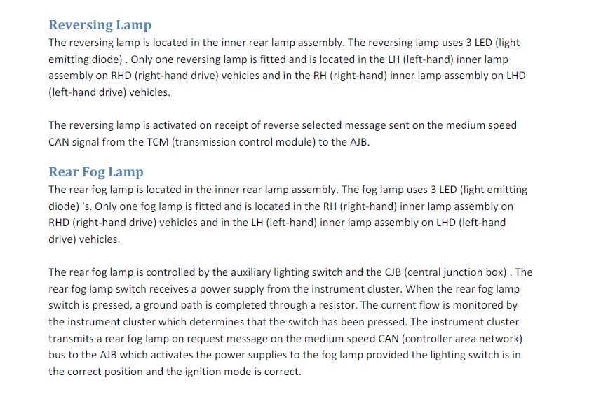

Some further detail on the circuit / switching from the Workshop Manual may help:
With the change you are considering, a second Fog lamp fed directly from the original with a cable across the tailgate concealed behind the trim should work OK.
