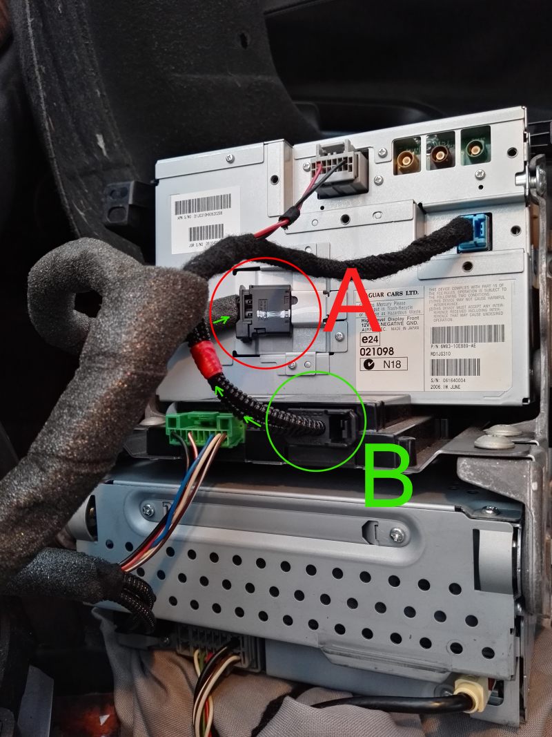

thanks for the comments, battery is not the issue, today I have tested it again. Here is what I have found out. First it is a fiber bus system, each component is looped through the next device, if one device fails somehow there might be a problem. Now I have checked the fiber connectivity with a laser pointer and figured out where the fibers are pointing to.
When I unplug the connector A (information and entertainment module) I could see a red flashing light from the device that usually should go somehow to the TSD module connector B (thatīs how it works on my second XK) . But it doesnīt. No light signal is passing through. The fiber connector A is not going to the trunk nor to any other device in the front, so I assume it goes into the amplifier and be rerouted back to the TSD module. This is the only part that I didnīt have swaped so far. Any suggestion where I could find the amplifier ?

I think the amp is in the passenger foot rest, towards the firewall, under the carpet.
