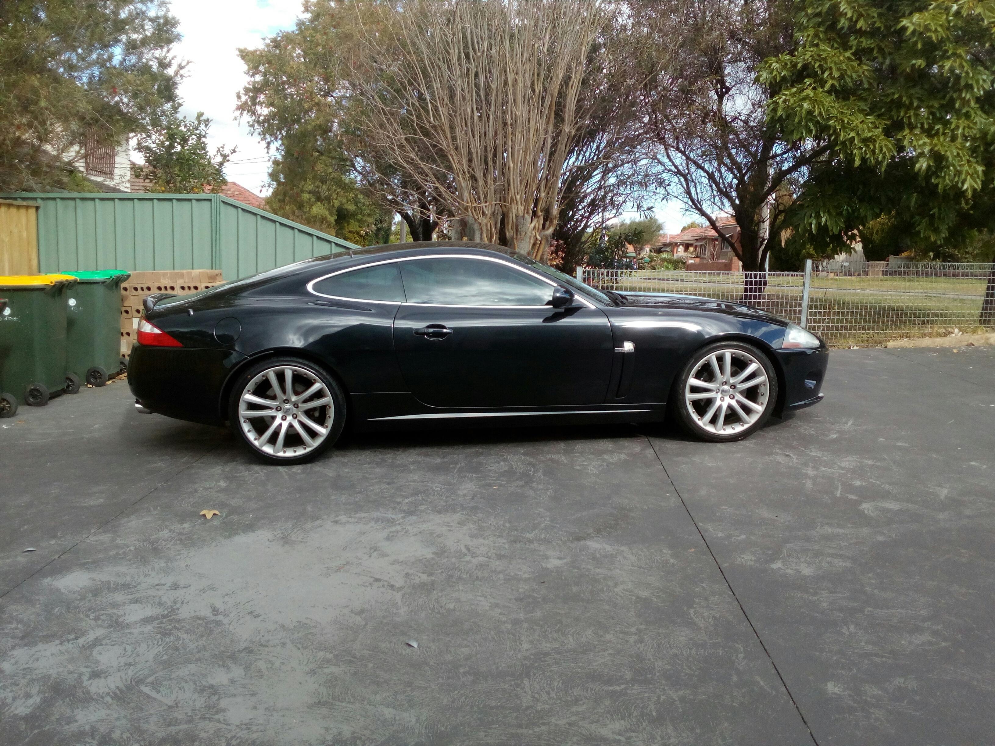

First time round the eibach springs were way too harsh thought I'd try it all again

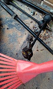

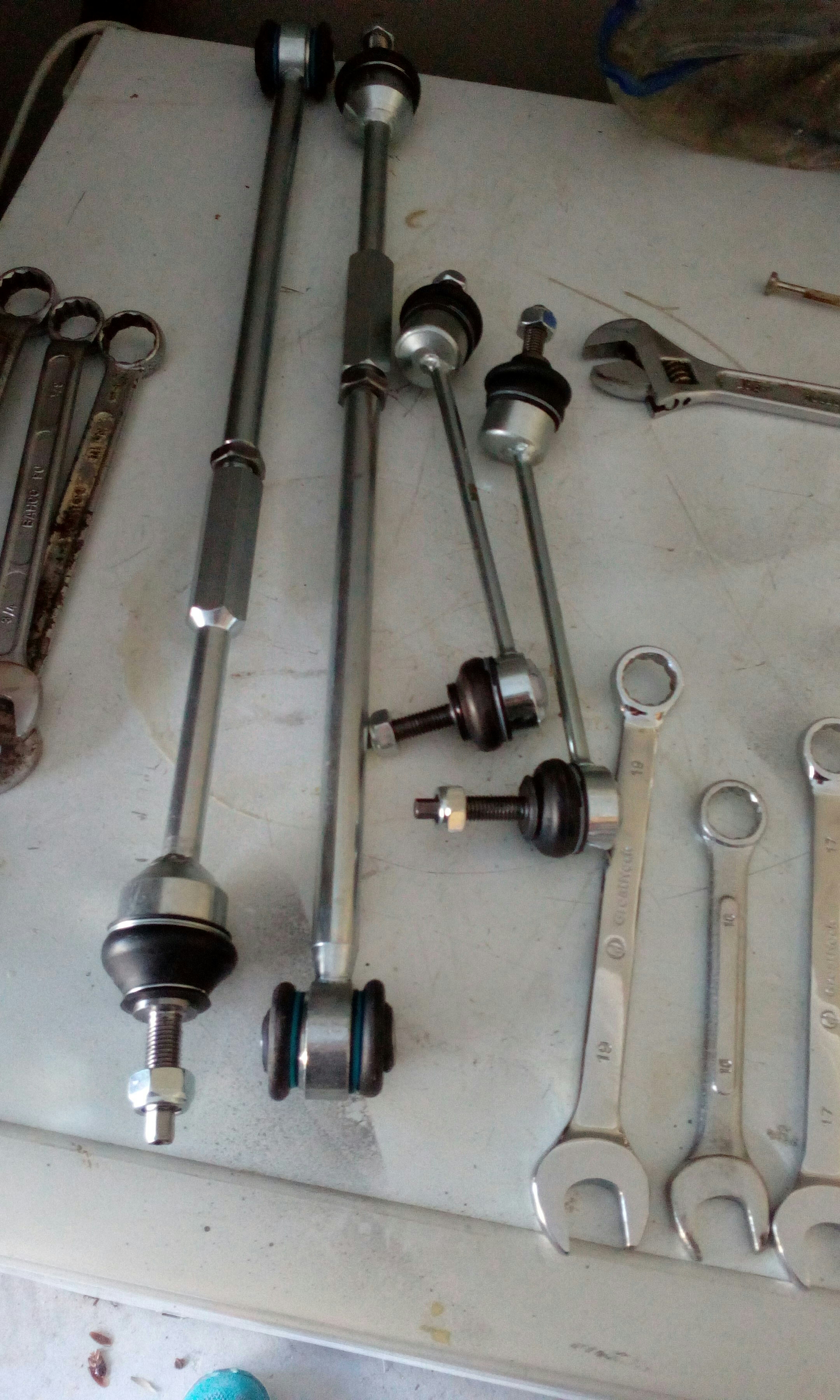

Task one was to swap out the worn stabiliser link rods and toe adjustment rods
After replacing these I had a quick poke around and my upper control arms look good however the lower control arm bushes are starting to deteriorate.

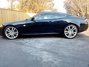

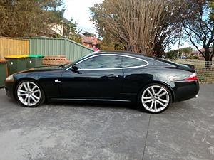

Then came the installation of the eiback rear springs (20mm)
Went for a short drive and the suspension didn't feel too intrusive in actually fact I didn't notice any difference in ride quality will want and see how it goes out on the open road

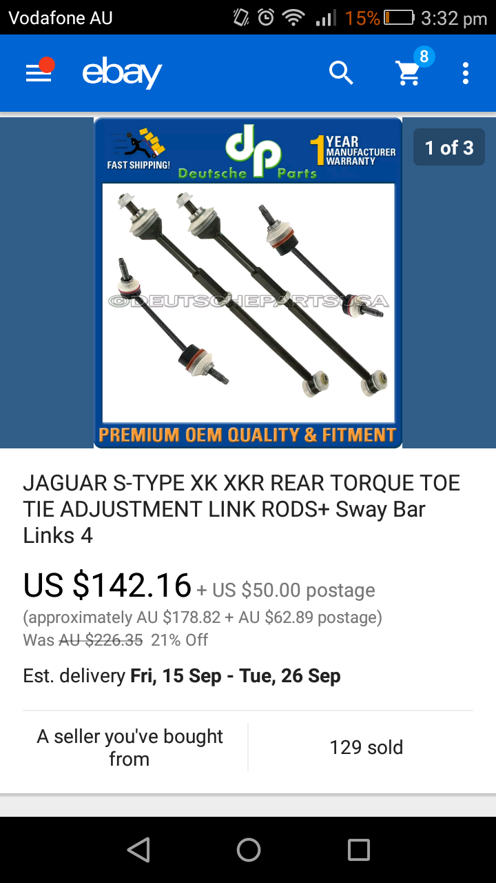

Eibach / Oem

Where did you purchase the replacement parts?? they look NICE!

They are currently running a discount

Straight out of the box these cars tend to have a floaty feel about them and can't be driven anywhere near their limit without feeling unstable
The eibach springs have surely made the xk feel a lot more stable, more planted on the road and lastly eliminated that unsightly wheel arch gap
