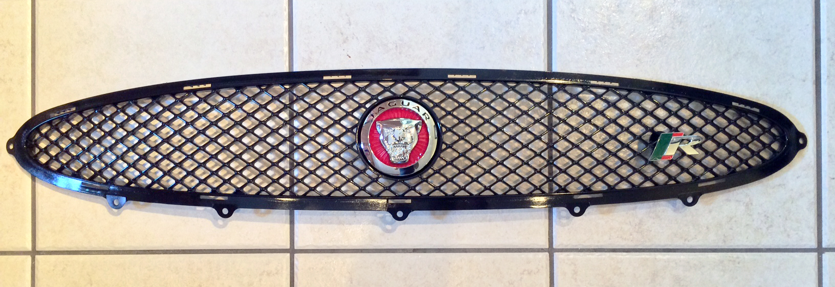

Just got back from Jag dealer. They had 2015 xk convert white, black top. All new ones have a red growler badge on the front grill and red growler inserts on the wheels. LOOKED GREAT! Does anybody know if you can replace the growler emblem on a 2009 grill with a new red growler emblem? Also can you just replace entire 2009 grill with 2014 or 15 grill with the red emblem? Thanks

Yes the growler can be changed, I did it to my '08 XKR with some minor modification to the mount on the grille but the grille has to come off and the only way to do that is to drop the bumper.
The grille however cannot be changed without a full facelift.

Here's a few more pics.
The F-type and 2014 XKR have the same growler in the grille. It fits perfectly in the concave recess once you trim the old style growler mount.
Dropping the bumper is not difficult just a PITA with all of the screws & clips. But well worth it in my humble opinion.

What holds the growler in the grill. Is it screwed in or held with 2 sided tape.
They are screwed in from the back.

Originally Posted by jahummer
From the Jag dealer for about $50
Just so I have this clear, you take off the bumper to expose back of grill, then unscrew the original badge and screw in the new one. This is not just a sticker you stick on top correct? Is it part # C2P25690. thanks
The original growler is indeed screwed in. You will also note the original protrudes from the face of the grille and not flush like the current ones. It is hollow and the grille has a somewhat matching protrusion that fits inside the growler which will need to be carefully cut off. I used a Dremel and was left with enough of a recessed lip for the new growler to rest on. I made a large metal washer for the rear side and screwed it all back together.
The final result is the growler is flush with the grille and fits the opening so perfectly it looks like the factory made it that way.
The part # you cited is not correct, that one is too small and intended for the XJ. The other part number mentioned might be correct but let me cheek my invoice and see what the part number was for mine.
Well I was wrong, according to the package from Jaguar the part number is indeed C2P25690
And I paid $42 for it.
