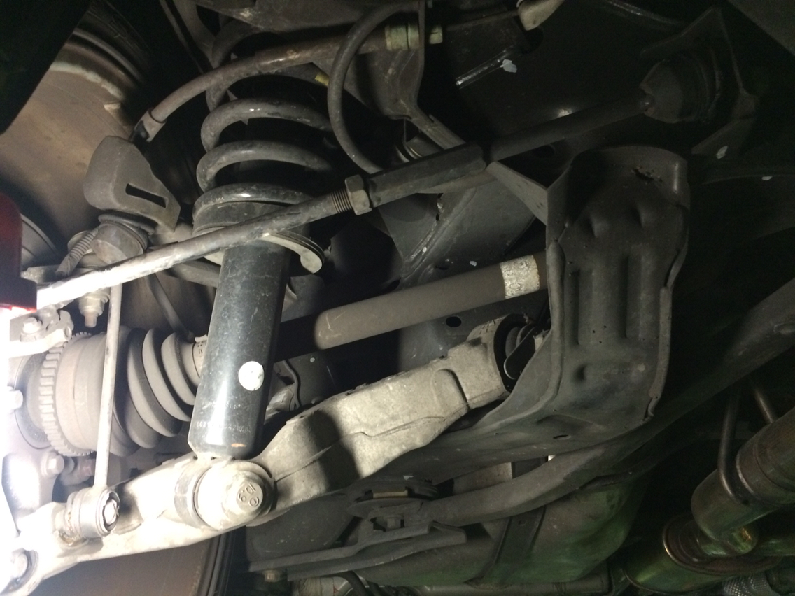

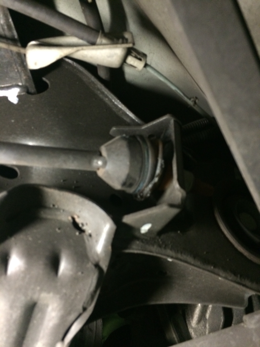

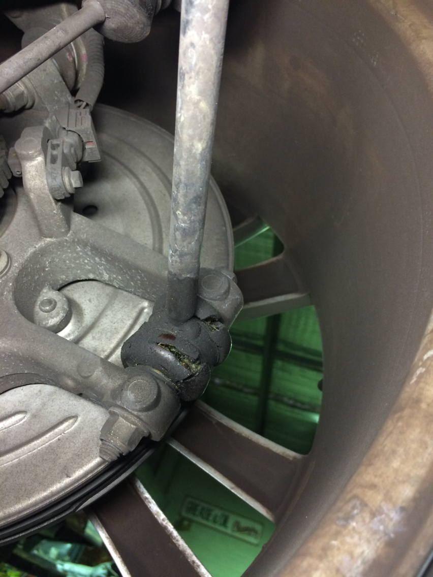

Jagtoes I attempted to load all the photos of the split balljoints/bushes but it appears my iPhone was unable to perform this task I will try again so everyone can see what I'm up for
Attached Thumbnails Sloppy rear end !!-photo174.jpg   Sloppy rear end !!-photo824.jpg   Sloppy rear end !!-photo270.jpg   Sloppy rear end !!-photo666.jpg   Sloppy rear end !!-photo814.jpg

Interesting and disappointing to say the least. What type of driving conditions has the car been subjected to. Either the rubber selection is not conducive to temps or something else caused the deterioration. Are you going with a urethane replacement ?

the surrounding parts look in clean order with no extensive visible rust, would the car have been subjected to salt water at a time maybe.
I won't lie the car does get driven hard I'm wondering whether the 285/20s and a low profile have anything to do with the deterioration ?
Back on the subject of the wheels they in fact one of the heaviest 20" rim I have taken on/off
When it comes to urethane where I can use it I will but with ball joint component there's not too much I can do but go genuine jaguar parts

The OE Jag bushings are grease filled rubber. Every Jag I have had has had this problem. The rubber deteriorates with age and the grease leaks out and eventually they develop too much play. Tire/wheel size and hard driving as well as salt have nothing to do with it.
Poly bushings will make for a much harsher ride and eventually will also wear. They are good for track use but not good for road use especially worn or uneven pavement.

The models are listed in my signature. The mileage varied from between 40-60K miles but as I said previously age has more to do with it than anything. The rubber dries out and the grease leaks out. Could be accelerated by warmer climates.
I will note that I have owned many other brands as well and Jaguar bushes have proved to be the worst of any.
