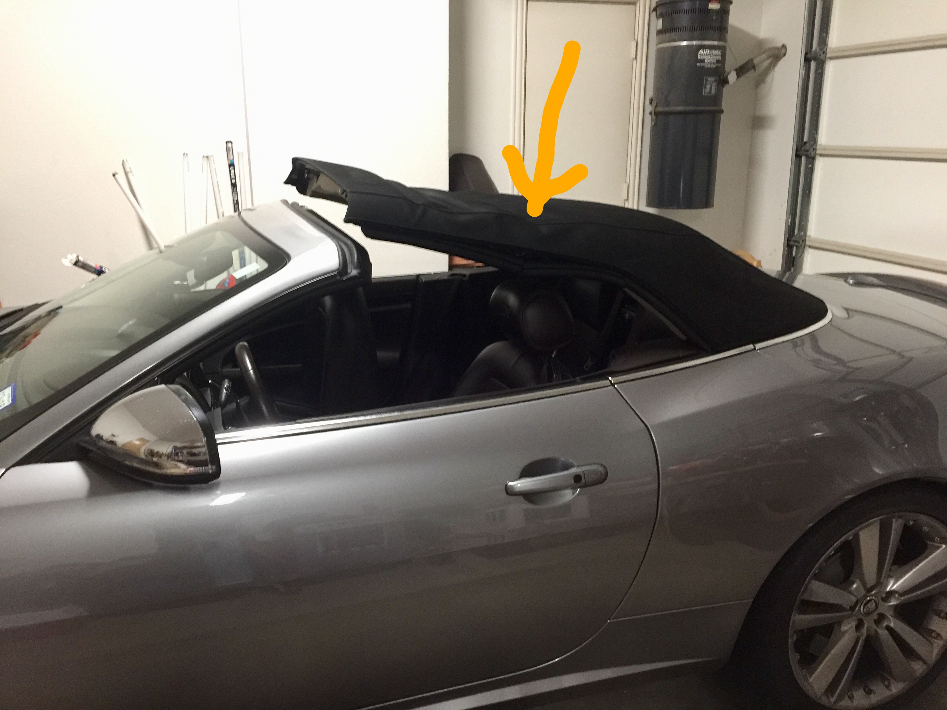

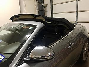

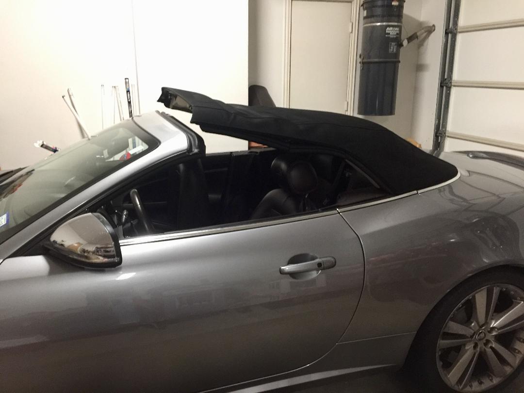

Here are some pics showing the stage where it's getting hung up. The rear part of the roof and the tonneau cover are both all the way down, but I'm still getting the "Hood not latched" message. Do you have any idea where the sensor for that is?
I'll leave the pump release open per your suggestion, but if I'm able to manually fold up and stow away the top, wouldn't that mean the pressure is also released enough for me to close the front all the way down? Or is there a separate line for that step?
To add to my frustration, I can't even take it to the dealer for a while since it's expected to rain for the next several days.

So I think I may have figured out what's wrong, but need someone to do me a favor and verify how things look on a normally-functioning top. The pics below are of the joint that won't close manually. I'm guessing the silver bolt head is supposed to be inside the wrench-looking thing I drew an arrow to, but it looks like it got dislodged somehow and is now blocking the joint. Not exactly sure how that happened, and I'm even less sure how to put it back in place, but I'd really appreciate if someone can snap a pic of how theirs looks in mid-operation.
