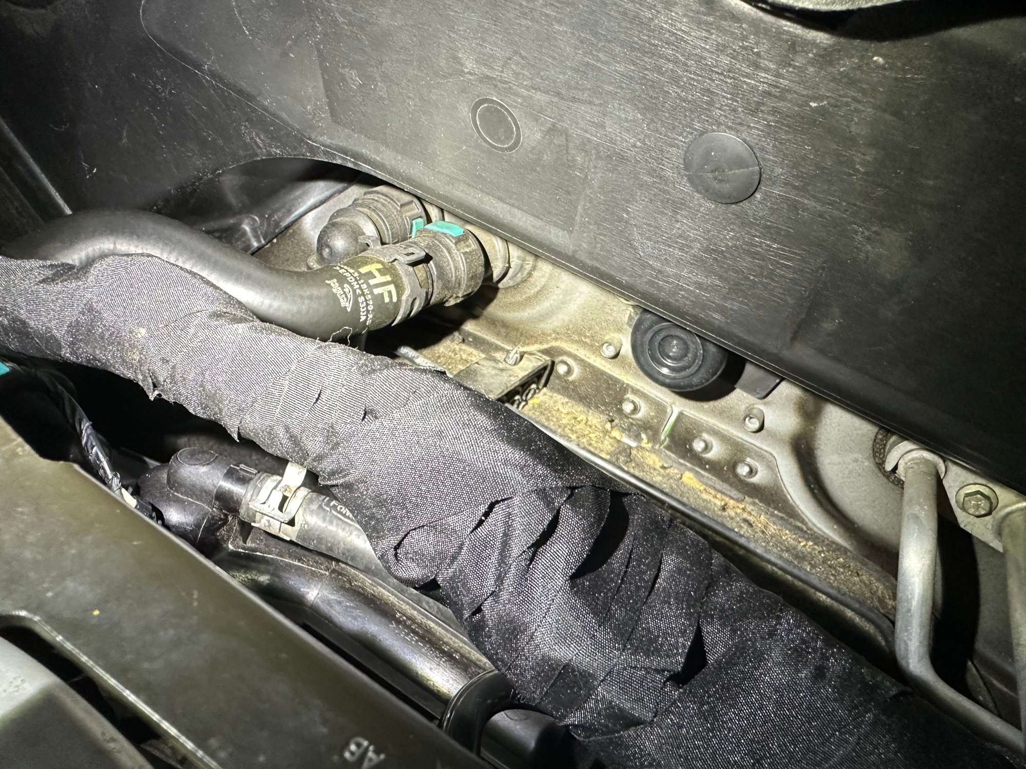

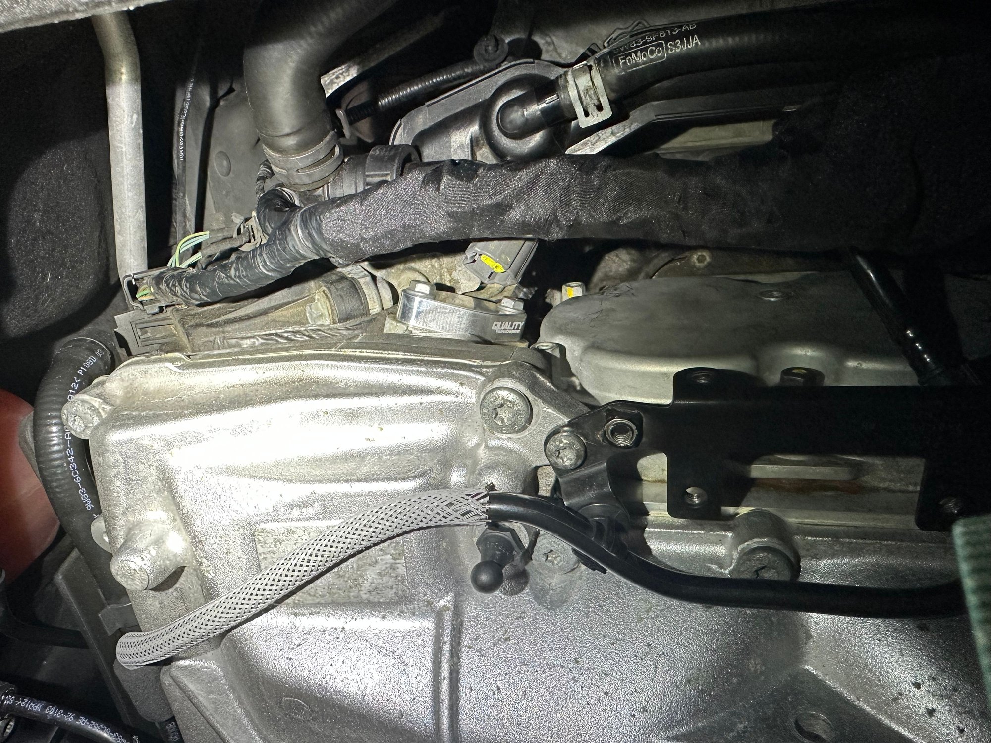

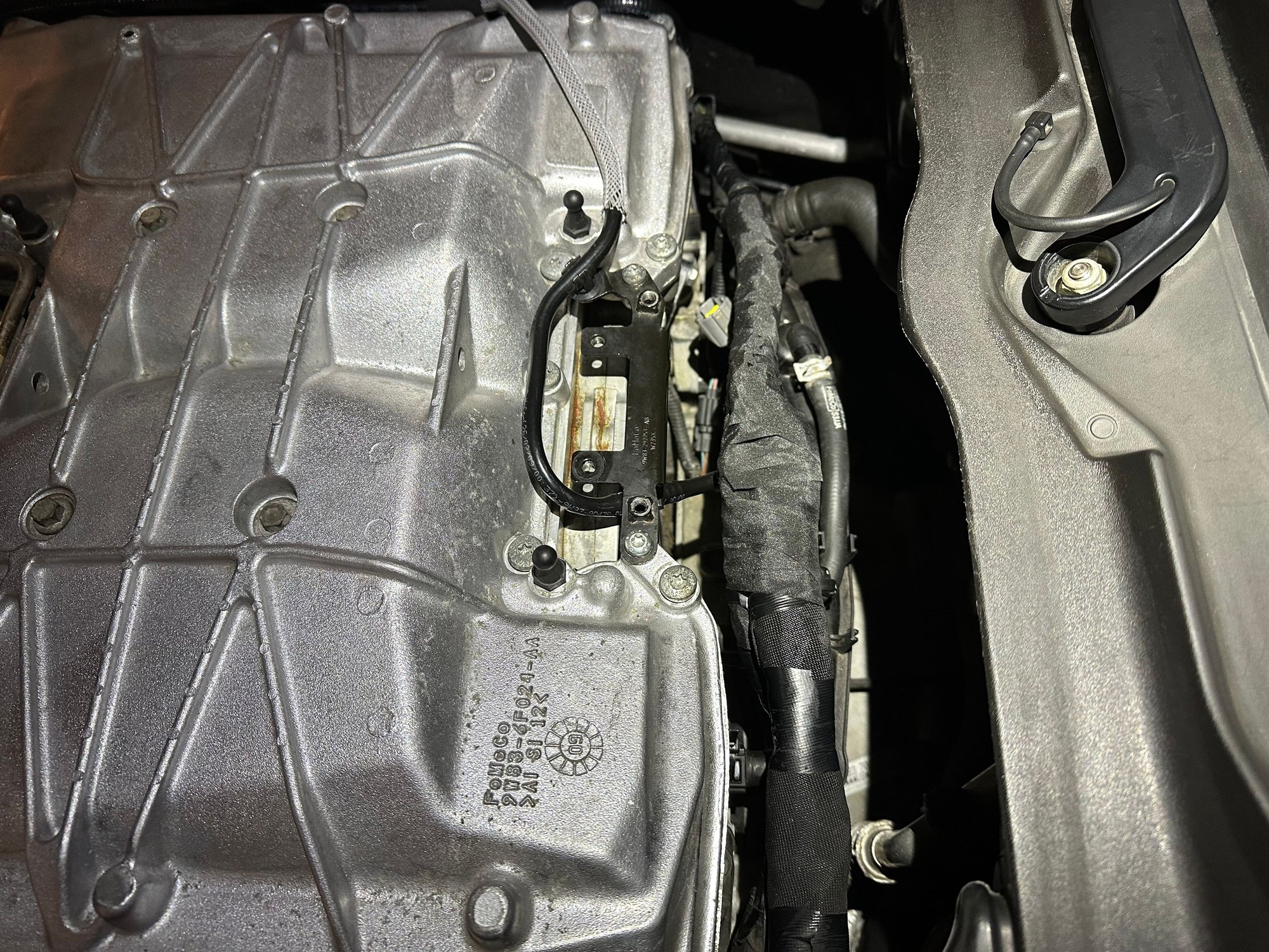

I recently removed the symposer in a 2010 xkr with supercharger in place
I used a blanking plate from “quality superchargers” on eBay
the old parts were brittle and some plastic cracked so wouldn’t recommend this job if you are trying to remove just for the sake of it. I permanently deleted
With the supercharger on, the trick is to unbolt / loosen the rear coolant crossover pipe like half an inch (you lose some coolant)
And then I just used pliers/snippets to cut everything - including hoses
no noticeable difference in sound/drone

Thanks for the great pics! I will definitely keep this in mind if I need to remove mine. Does it help at removing it for a suppercharger oil change?
I think so as it clears up the area and can see the fill and drain screw.
