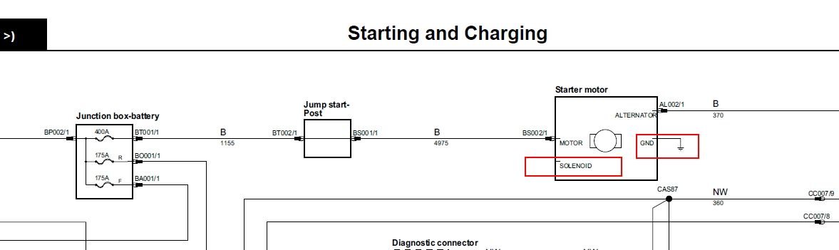

Perhaps... but I'm not that far along in the diagnosis to suspect a relay. Though agreed, if the start signals are being received...
You mention the battery at 12.5. What's the voltage at the Central Junction Box AND the Auxiliary Junction Box.?
Anyhow, As you asked, found these.
File Type: pdf

The ground should be easy to check, get under the front of the car and follow the ground lead on the starter. Next you need to make sure the solenoid is getting the start power. You mght have to connect a wire and run it to a volt meter where you can see the meter while attempting the start. Intermittent issues can be a pain to find.
