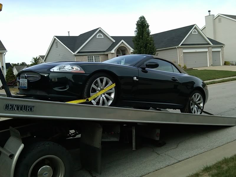

I wonder why Jaguar USA doesn't inform their dealer ships/service managers of this? My 08 visited two different dealerships in two states (Mo and Il) during a 4 month period. The last time was on a flatbed to Jaguar of Peoria
Total down time to me was over 6 days. I finally replaced the battery that both Jag dealers claimed was "OK" in addition to the alternator and even hooking up my car to something listed as IDS on my repair order to update all the software. And still my 08 would act up. Some of the symptoms were:
1. LCD screen locking on the Jaguar logo
2. IC LCD screen (clock etc) would disappear or be upside down
3. The windows would lose their indexing for no reason
4. Dimming headlights when any electrical load was added i.e. turning on seat heaters
So now I have a brand new battery and I will lock my car EVERY time I get out of it and hope that's the end of my electrical gremlins.
Guess I'll take the time and contact Jaguar USA and point them to this thread for comment.
