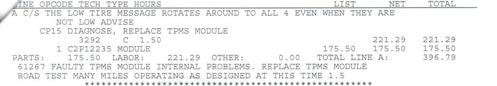

Fixed! While I had it at the dealer for it's 60K maintenance I had them check it out. I had a bad TPMS module. Turns out the module is much cheaper than I assumed it would be. I am happy again. It was repaired at Jaguar Plano and my service advisor was Roy.

Thanks for the information. BY the way, if it returns in the near future, please make another post stating so. The $175 is fairly cheap. Much lower than expected. I might go this way and buy a module.....after I check and make sure my rear initiators are in place and not flopping around.
I looked online and found one from JaguarMerriamParts.com for $144.61. Of course shipping would up that figure a bit.

If it makes a peep I will let you guys know.

$175 for the TMPS module? Wow, I was quoted $400+ at Autobahn jaguar. Is it a bear of a replacement or is it plug-n-play? From what i have read, it's behind the back seats, right? Still haven't been able to check the rear initiators but hope to get to that tonight.

GWTBOX..................after replacing the module, the facory manual says "Using WDS, configure a new module". So I'm guessing it's not plug and play. I just know what I just now read in the manual.
WDS acronym stands for WorldWide Diagnostic System.

Just an update. I have been running clean since the replacement.

This is a great post. My dealer is charging me $670 for the exact same service at Jaguar Elmhurst in Illinois!!! Maybe I should drive my car to Texas????
