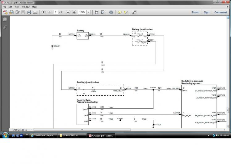

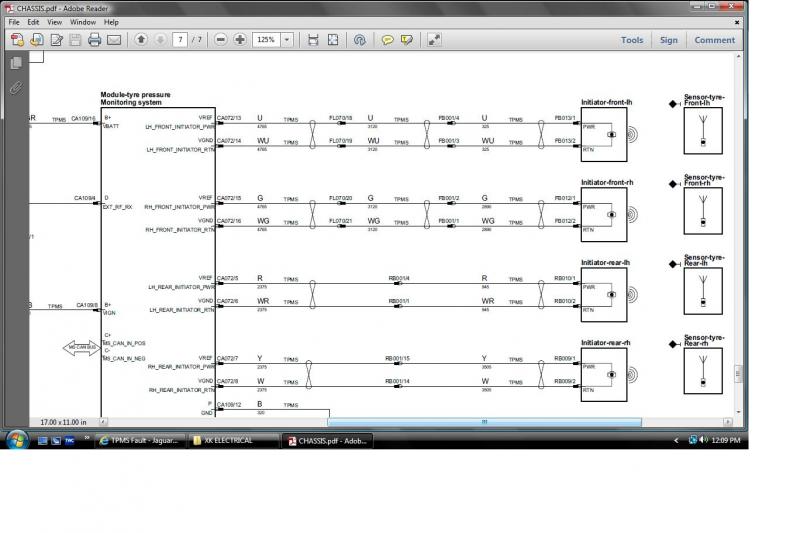

I've a similar problem on my 2007 XK. The problem comes and goes several times during a drive.
The shop manual shows the pressure sensors in the wheels........two antenna, one in the left front wheel well and one in the left rear wheel well.........the monitor located behind the rear seat backrest.........and a reciever located under the console. Just some FYI for you.
The two jpgs represent the front and rear antenna on the left side of the car in the front and rear wheel wells........after you remove the access panels.

Old Aug 14, 2012 | 11:53 AM
Hailers's Avatar
Joined: Aug 2012
Posts: 379
Likes: 98
From: FORT WORTH TX
Attached Thumbnails TPMS Fault-tpms-two.jpg   TPMS Fault-tpms-one.jpg   TPMS Fault-tpms-three.jpg
