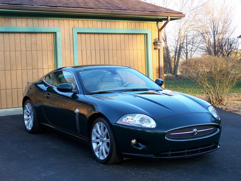

I have a 2007, and also like the look of the newer mesh grills. I was wondering how involved the replacement process was. I have time, and a fair assortment of basic hand tools, but I've never taken a body panel off. Do I need a lift to get under the car ? Is there perhaps a "Step by Step" posted for this, that I have not seen?
Thanks !
Thanks !
The grilles do come with some crappy instructions. No text, only a few vague diagrams.
I had the dealer do it. I know they had to take the nose section off. I don't know how hard (or easy) that is.
