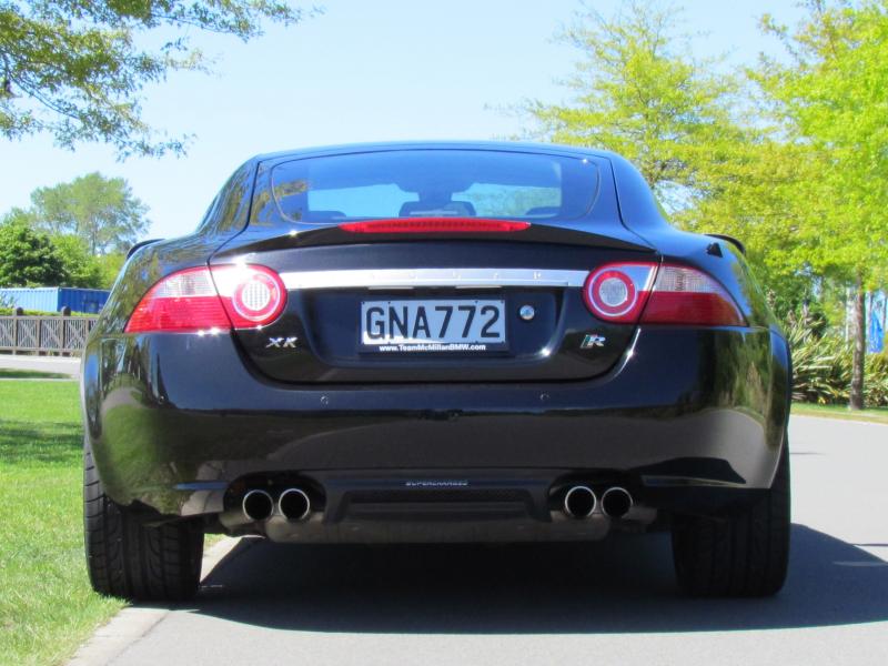

I am not in the same country as my RHD XKR at the moment but as you can hopefully see from the attached pic the left hand side looks like a reflector and the right hand side is the reversing lamp with 3 LED's.
The 2009 Jaguar parts guide has the following part numbers for the reversing lamp:
LHD - RH Rear
USA - C2P9918
Except USA - C2P3560
RHD - LH Rear
C2P3562
