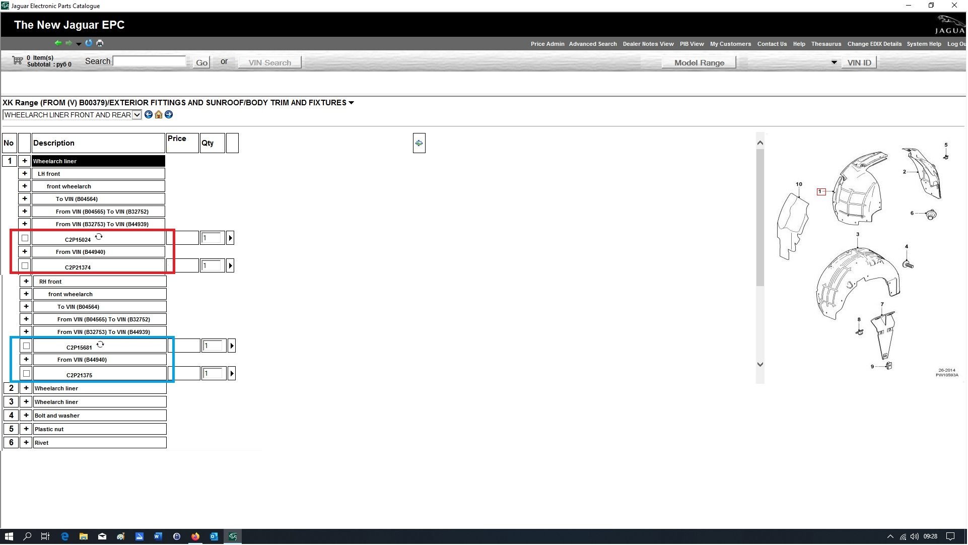

My 2019 JEPC is showing C2P15024 and C2P15681 as superseded by C2P21374 and C2P21375:
JLR are showing as out of stock on C2P21373 and availability on C2P21375:
