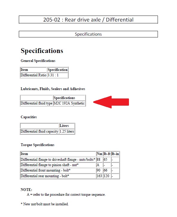

Need an answer quick: Anyone know what is the correct fluid for the differential on a 2008 XKR (portfolio edition)?
My car is already on the ramp having a Quaife LSD installed, the guy wants to know what to refill it with. I only want to use the Jag-recommended stuff but don't know what that would be.

From the Workshop Manual:
Urgent: Need to know correct Differential Fluid-xk-diff.jpg
