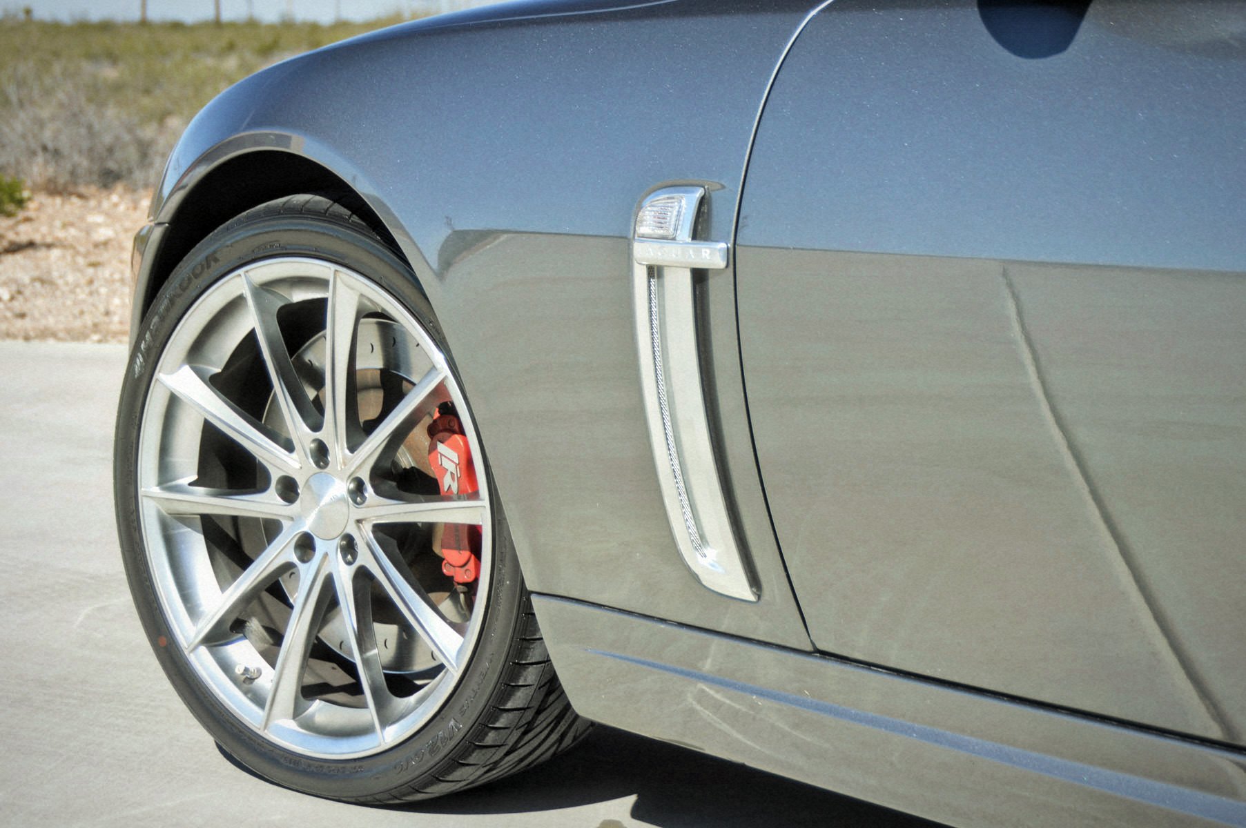

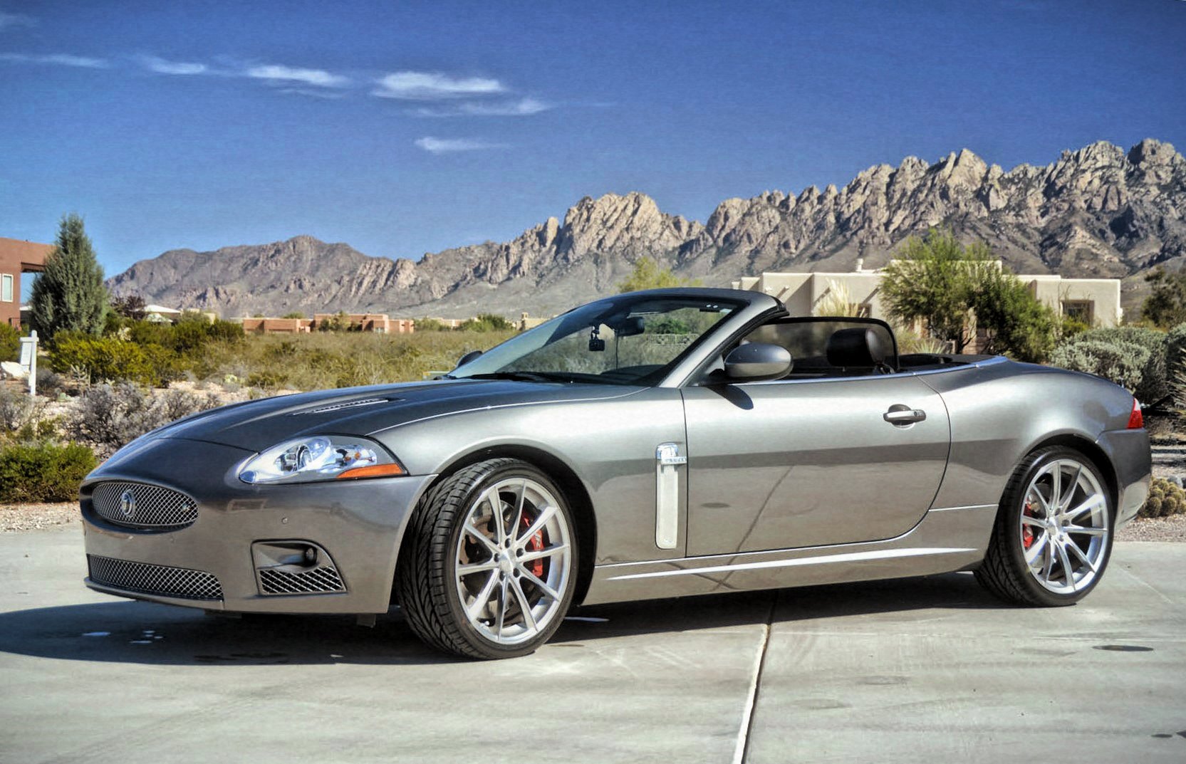

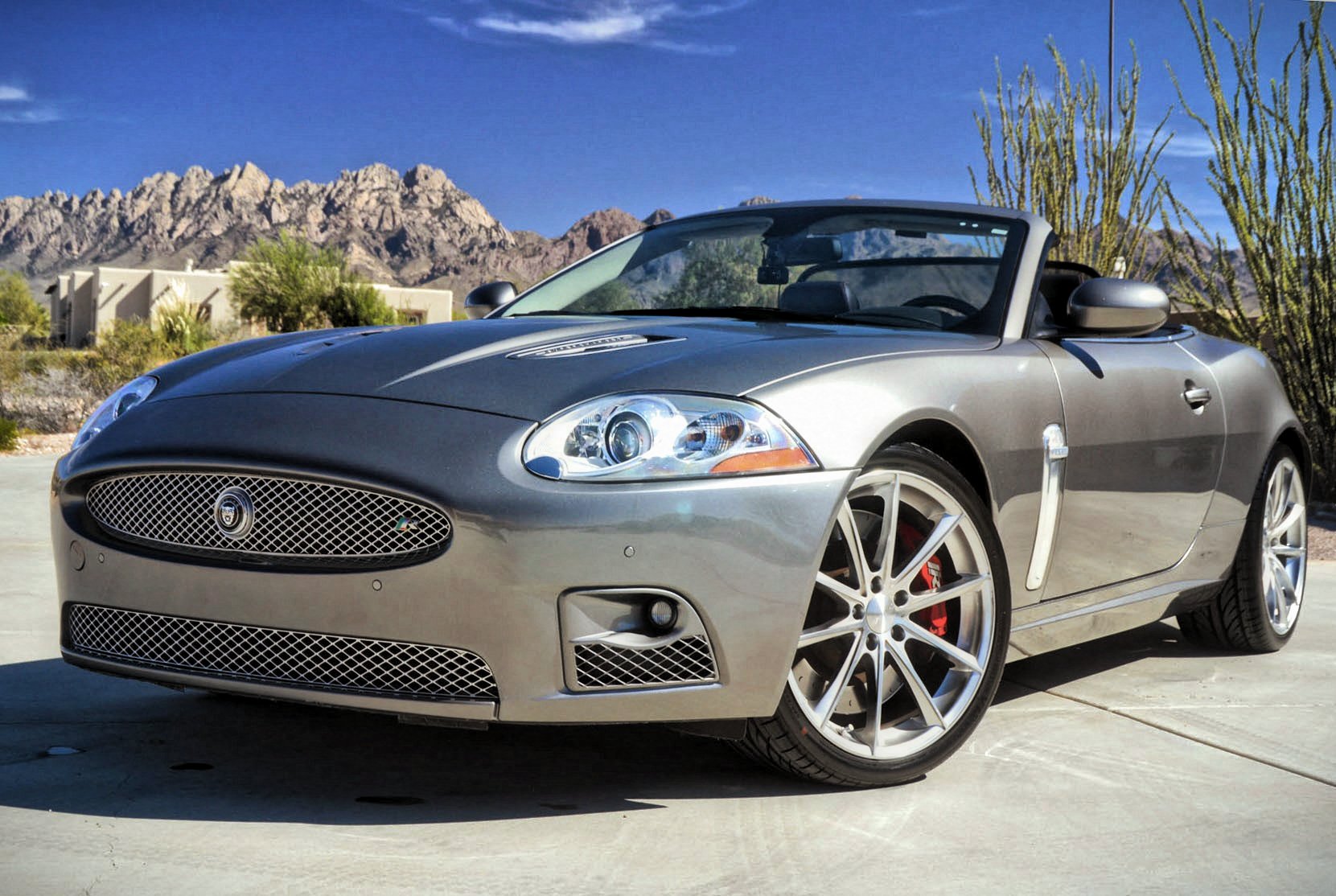

1st) Try the Coventry Wheels which are made for the Jaguar brand, and they are very well priced. For under $1200 you can get a great set. Discount Tire sells the Coventry brand. There are several Discount Tire stores in the Tacoma/Seattle area.
2nd) I worked with Fastco in Canada to make wheels for my 2009 XKR Portfolio Edition. Although my wheels had to be custom milled for the Alcon brakes, your wheels at 19" poses no problems in finding a nice aftermarket wheel. These are the Braelin BR02 wheels.
My 20" wheels delivered to my home in New Mexico was under $1300.00 for al four including a new lug set.
A 19" set would be closer to the $1100 to $1200 price. You want to find a set made in the exact offset, and center bore for the Jaguar, so no wheel spacers are used.
Here's my 2009 XKR with the Fastco Braelin BR02 wheels in 20" front and rear.
