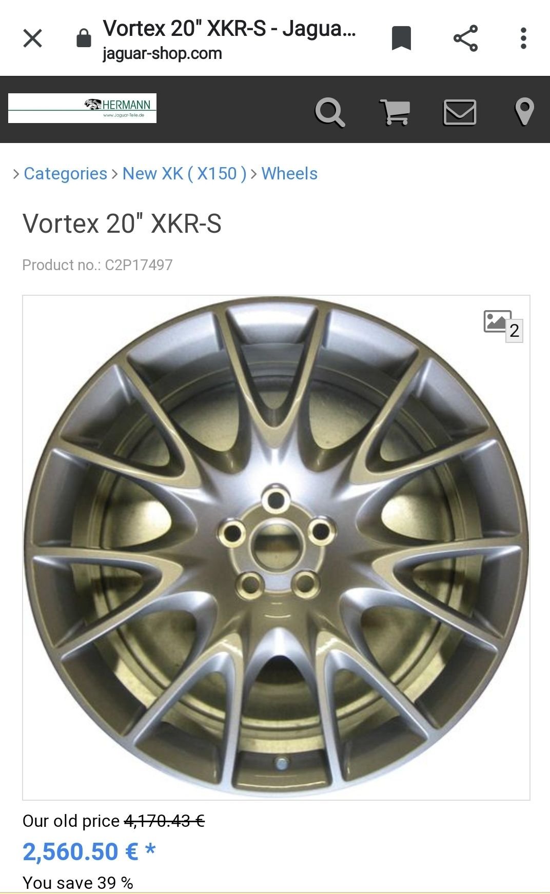

Vortex 20" is the best looking XK wheels pattern. Looks like it would be strong wheel compared to the other 20" XK options.
Old Feb 27, 2021 | 11:15 PM
Stuart S's Avatar
Posts: 10,124
Likes: 7,127
From: Atlanta suburbs
I agree with you that the Vortex design. But ...
The OP has a 2007 XKR and is in California. In the USA, Vortex wheels were introduced with the 5.0L models. Unfortunately, they don't fit the 4.2L models.
Because the 5.0L models have the E-Diff, the rear offset is different from the 4.2L. The rear wheels won't fit, but the fronts will.
In Europe, the Vortex design was introduced on the 4.2L 2008 Model Year XKR-S. That model was not available in the USA. Those wheels would fit, but they're rare and very expensive. I'm pretty sure they were forged, not cast.
Agreed and have a set for Summer and black Vulcans for Winter, they are both (IIRC) 10.5 at the rear and 9.5 at the front and has been stated a different offset.
I think that only Alcon brakes have a problem with clearance when downsizing and that wouldn't apply to OP's car for any 19" official Jag wheel or decent aftermarket

in case someone is interested- there are two sets of "old" vortex wheels in Poland (for 4.2 rear axe). They cost about 1,5k usd for alloys only. One set is silver, the other one is repainted for black + Cnc.
shipping to us would cost a fortune, but to UK - I can help arranging it for about 300usd.
