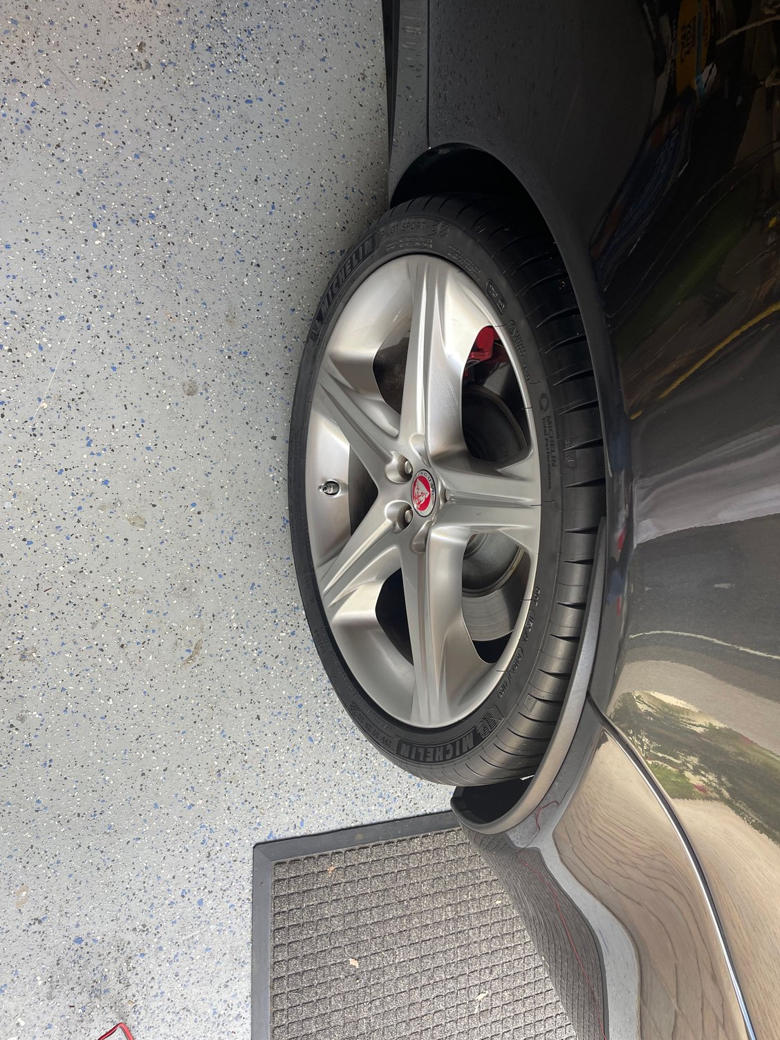

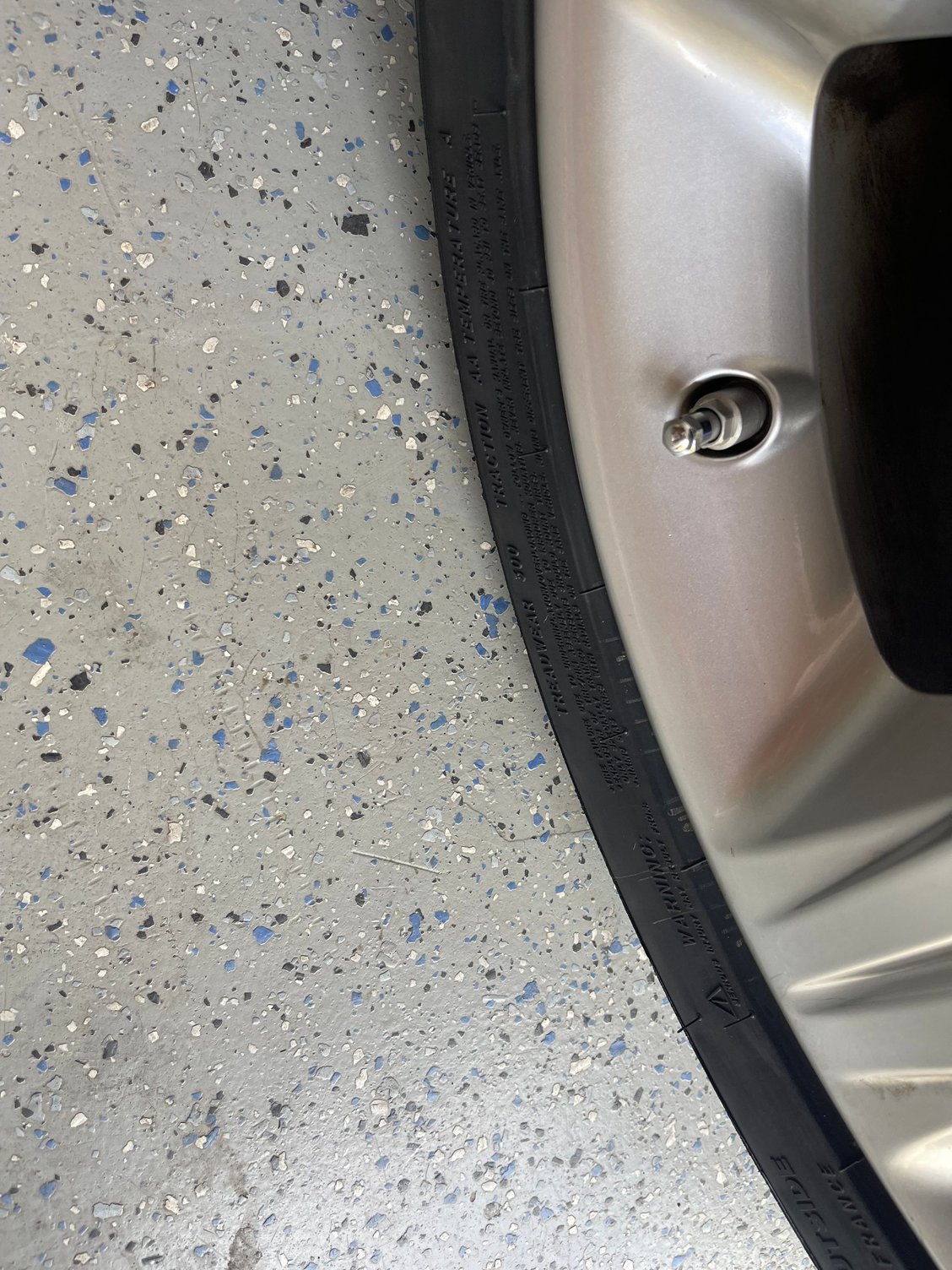

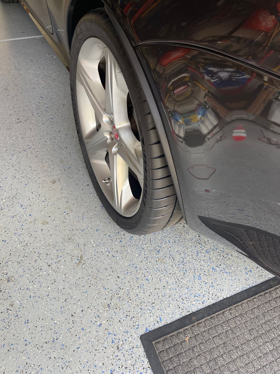

So, I’m going to skip the spacers. I just had new tires put on all 4 corners. The OEM size (285/30ZR20) was on back order, so I went one size over to 295/30…it’s no5 much of a difference, but i think it looks better, and I wouldn’t want to go any wider. And I like how they protect the rim a bit.
